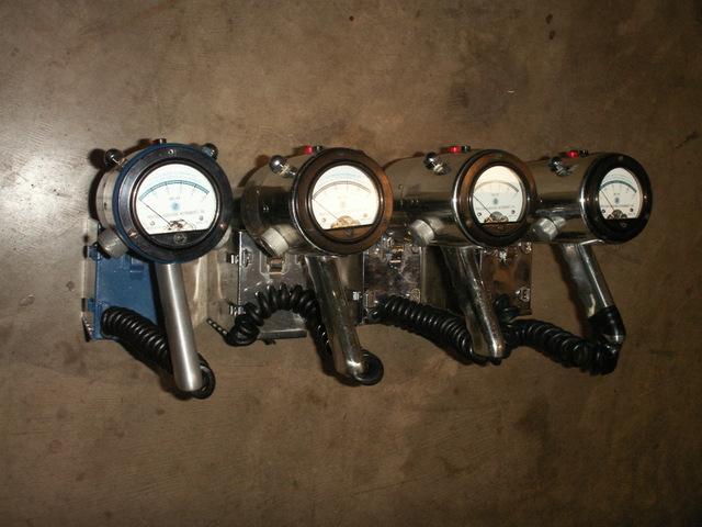

    More Bickel unit photos
    More photos:

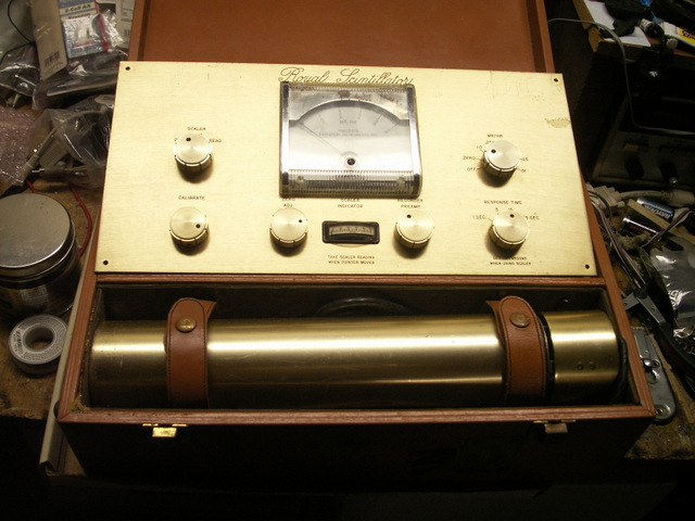

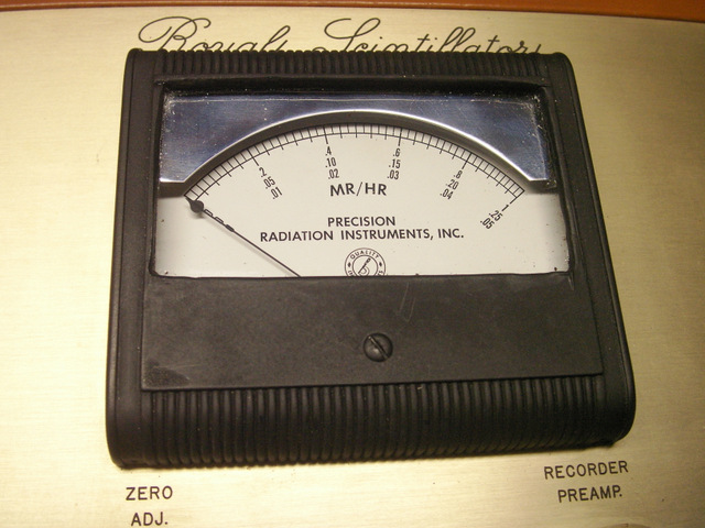

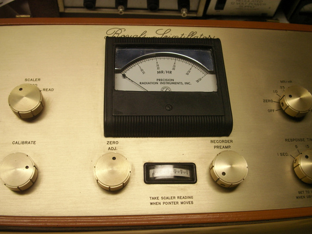

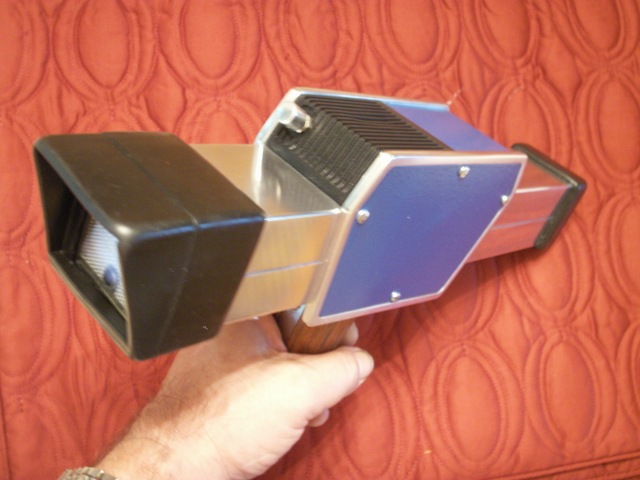

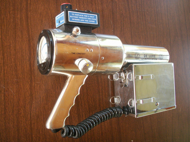

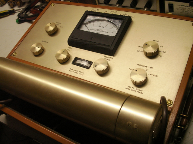

              Vintage units similar to the Bickel Detector
              For comparison here are some Photos of a Vintage scintillator (gamma ray detector) unit similar in function and sensitivity the BICKEL unit. The PRI-118 was manufactured and sold during the mid to late 1950's. It utilized sub-miniature vacuum tubes developed during WW2. The appear from time to time on EBAY.

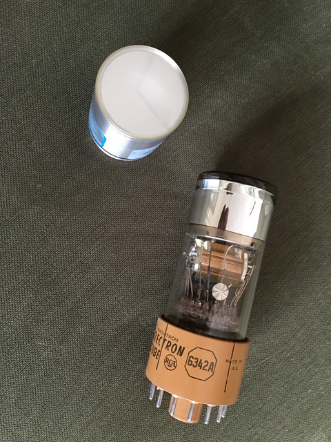

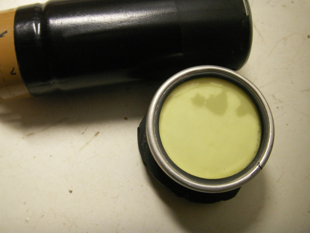

                Photo of a bad NaI(t) scintillator crystal
                Notice the canister below with the yellow crystal. The rubber O ring seal has leaked allowing moisture into the crystal housing. Crystal units constructed in the 1950 had this problem. They typically lasted only 2 to 3 years. Once yellowed they become useless unless the crystal is removed and replaced in a moisture free environment. Sometimes they can be re-polished. In the 1960' on, manfacturers started to hermetically seal them so that they would last longer.
                As mentioned in previous posts by me, NaI(t) is extremely toxic and hygroscopic. It corrodes quickly when exposed to any moisture in the air . Ggreat care and precautions most be made when replacing or re-polishing it once it has yellowed. Once yellowed and no longer transparent, the crystals are useless.
                The crystal along with the photomultiplier are the heart of any scintillator unit. The rest are simply electronics that process the output from the photomultiplier tube.
                In addition to Nai(t) other materials such as special plastics and other compounds are used for monitoring certain bandwidths of the X-ray/Gamma spectrum are used today.
                The myth that only the most sensitive scintillation crystal and/or photomultiplier tubes are only available from Germany is inaccurate and false. Both are now manufactured worldwide by many firms including some in Russia and China.

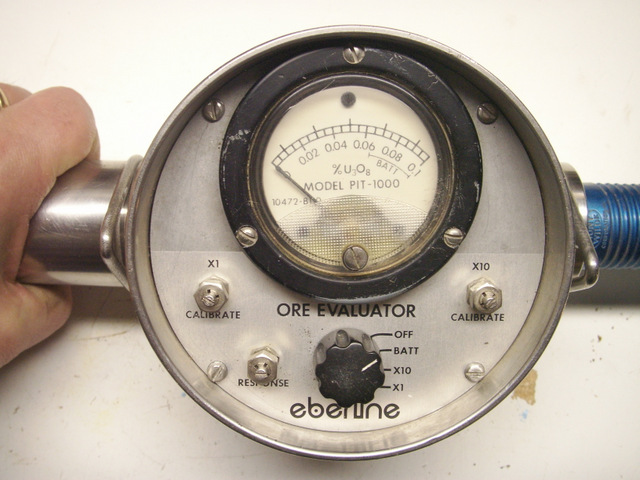

                    See below some pictures of common vintage scintilltors we've restored.
