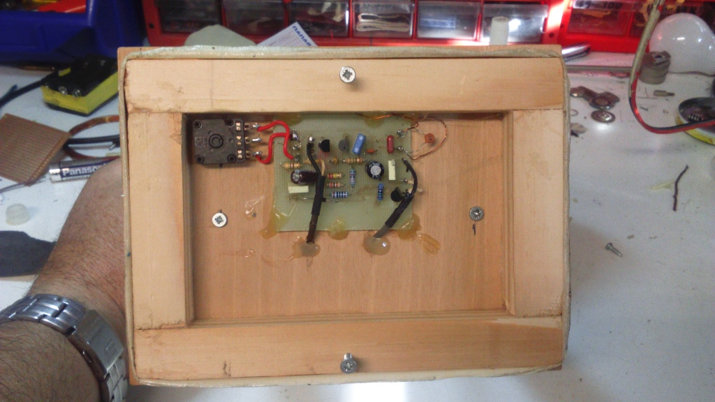

i constructed it long many years ago (maybe 10+) with all mods and adds.
Results at my area was not good. It located only some small objects from short distance.
I keep it yet
It is a good way for someone to construct a lrl and play with it with little money, compared with the money that has the commercial
The basic is to put the preampl inside the coil. Also a potentiometer to control the gain of preamp is neccessary. I don't know who freq is the best for your area. Play with all by changing the tuning capacitor. I prefer 80 ... 100Khz.
I attach a photo from the head of my lrl...
