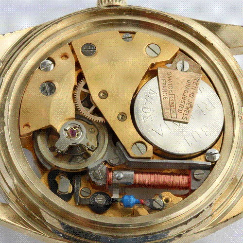

    • Oops, the batteries have dropped, it's a pity I still have not detected the electric watch, but I have good results
      • the watch I used has no coil, it is not normal with this high sensitivity and I have not been able to detect it, I think it must this model ???
        • If your watch is n't the proper... use a wall clock... they have the same machine.
