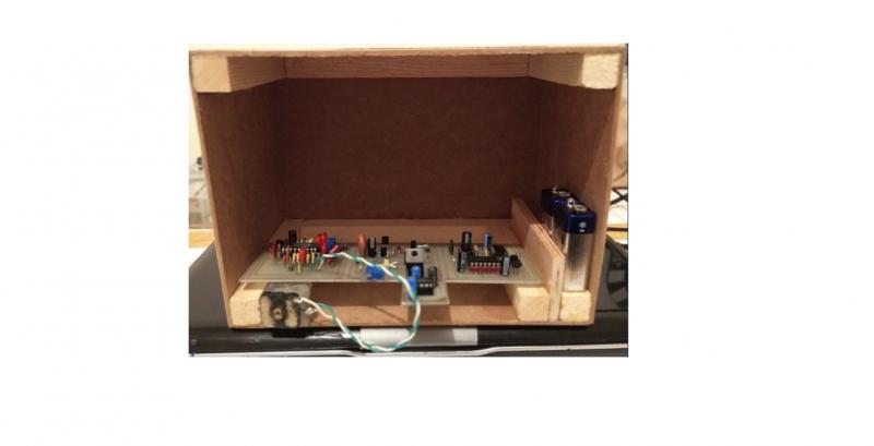

        • DCH85
          Originally posted by abdou2014 View Post
          this is my first experience with DCH circuit , without TDA stable and work, detect switch spark
          but not yet successful with the TDA, maybe there is an error in the circuit ????
          one important thing about the DCH85, if you make the antenna correctly, it will locate your hand energy and a plate of metal near the antenna, if not, it means no power to locate the PHENOMENON

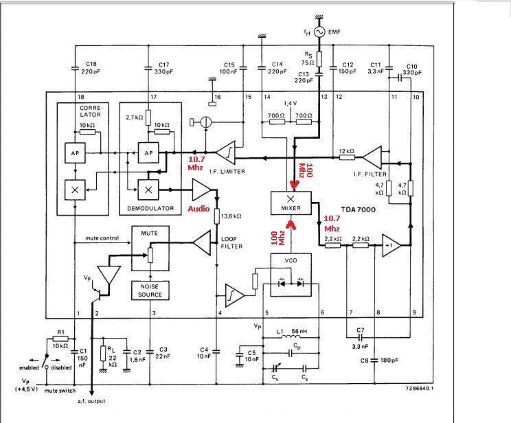

                    • is pin 13 of the TDA connected to an antenna or not ?
                      in which frequency range should we search via variable capacitor ?
                      Thank you !
                      • Originally posted by abdou2014 View Post
                        Thank you !
                        You can modified from this Sch of 7000

                            • PDK-3
                              Thank you !
                              yes, it is the 13 the antenna pin. but I see Esteban put CV1 (adustable capacitor ) 10-20pf, that cant pick targets,need 10-70pf, most PDK-3 I built pick the gold with 56pf value...

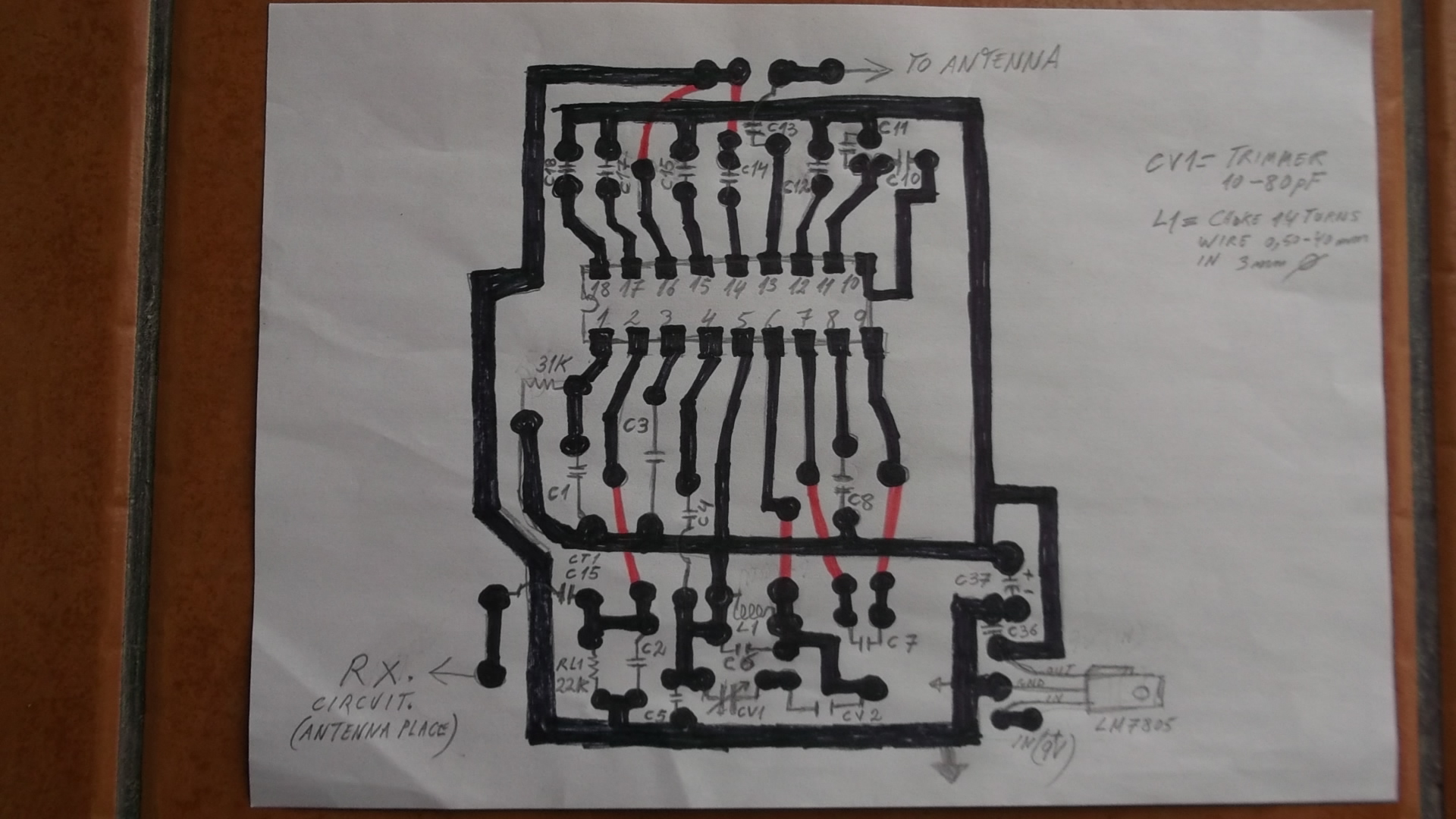

                              • TDA 7000 RADIO for DCH85
                                Thank you !
                                this is the TDA , I use and it works fine :
                                I believe it can bring all the DCH85 from the deads to a living form,if its correctly tuned...
