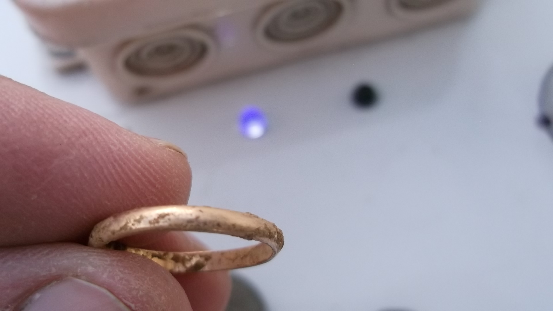

Manolo sent his PDK for modification with KIT IR/UV, before open the box I made test in the place of the silver bracelet and it is working , he said not work in Italy ...

I made the test on the silver bracelet before the upgrade, I see that you put a ceramic 4N7 for frequency resonance, and it was locating the bracelet when I made the video :
Hi Morgan , in Video I see UV Led left of Battery box , but where is IR Led ?
May is in Right side of Batt box .
With using UV/IR Leds Kits system , Distance of Finding Buried how match is different, (Cm or Meter ) ?

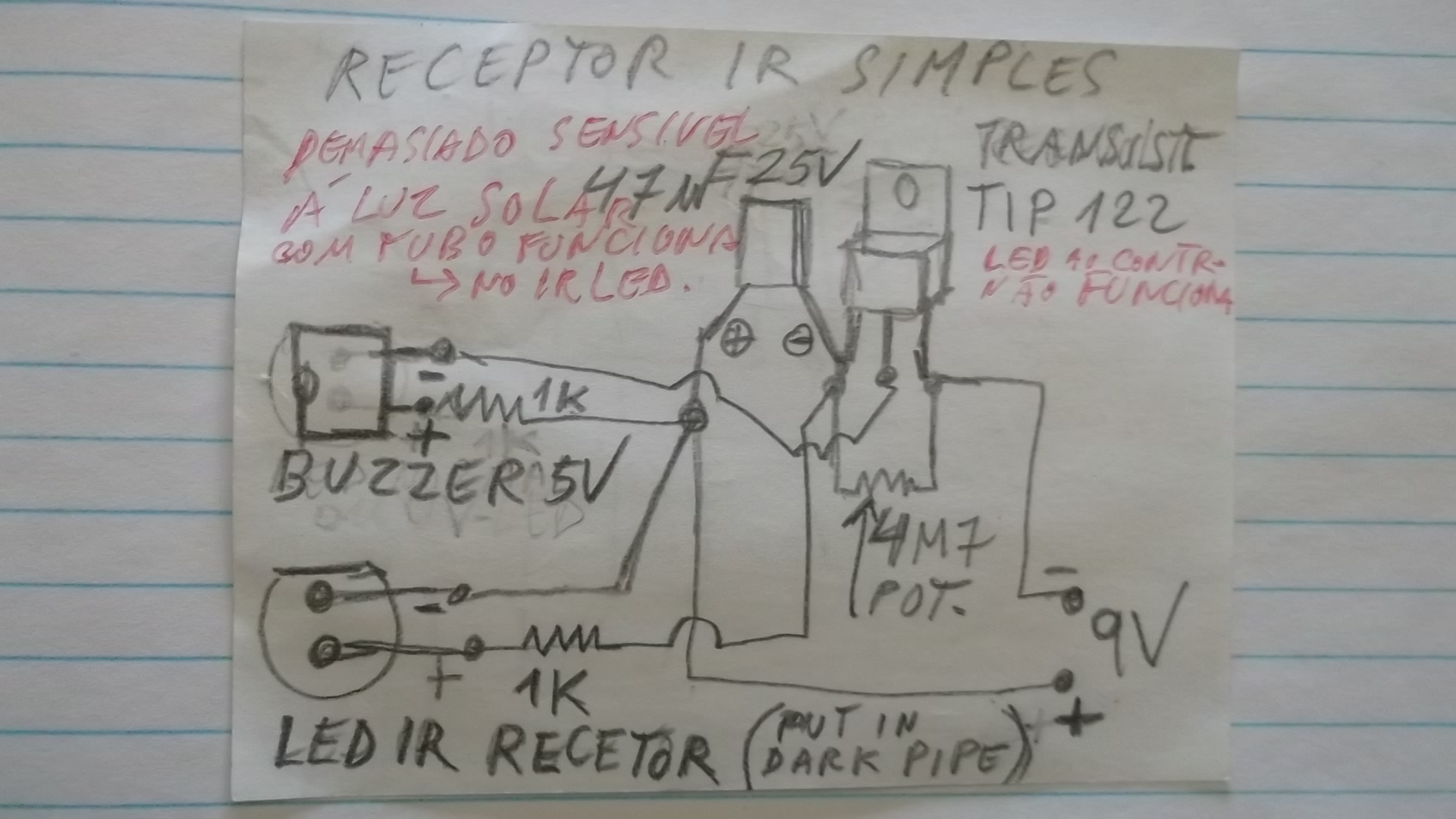

all entusiasts can play with this short range IR receiver, you can use rx LED IR 740 to 940nm ,need to instal the LED in a dark tube to work, very good for beginners experiments with Infra Red locators,very simple and easy to get TIP122
humhum with your big knowledge in electronics ,you can modify or upgrade this simple shematic .
if interested on that, put here the upgrades that you will try in ISIS proton program,share to all entusiasts and believers !
Ok Friend , But now I am busy , that I build Alonso Passive -PDK with many different values and Coil voltage is near 22 Vpp , also have Discrimination of Metals , but now I search in my Garden buried correct set Frequency for Beep , after finish this Project , I can Try for IR project .
