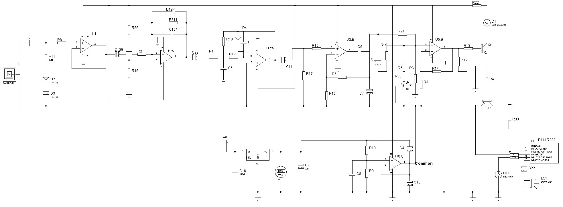

    [IMG][/IMG]
      very sensitive
      I recommend making them, as the hand senses over 20 cm, the computer senses over 5 meters and many advantages
        I shrunk the antenna so that the amplifier will not malfunction
        By extending the antenna, it picks up the TV signal from 3 m
          preamp high impedance
          This circuit is very high impedance Preamp, this schema sharing one Friend from this forum.
            You must use CA3130 (very high impedance), 741 operational has a very low input impedance.
              ZAHORI WORK FINE WITH CA3130
                I added a 50hz notch filter

                  it's active antenna for sound card VLF reception , it's not an LRL
                    https://www.qsl.net/dl4yhf/speclab/vlf_rcvr.htm
