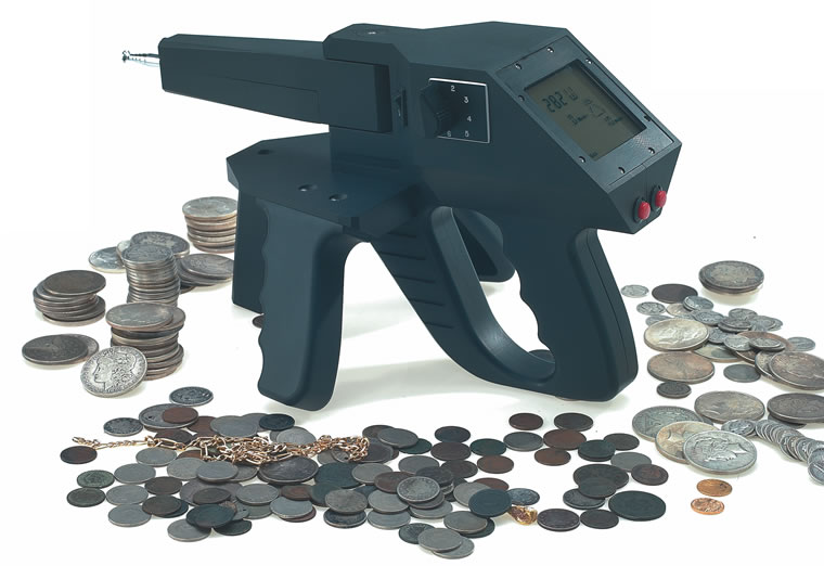

What an excellent report! Thanks for posting this.
It is our conclusion that the claimed theory of operation of dielectrophoresis being responsible for the motion of the antenna assembly is not correct. In the absence of DEP forces causing the antenna assembly motion, the only available sources for causing the motion are (1) operator motion, (2) gravity (gravity makes the antenna rotate when the handle is tilted even slightly), and (3) wind. It is also our conclusion that the device cannot function as a passive long-range detector of human heartbeats.
