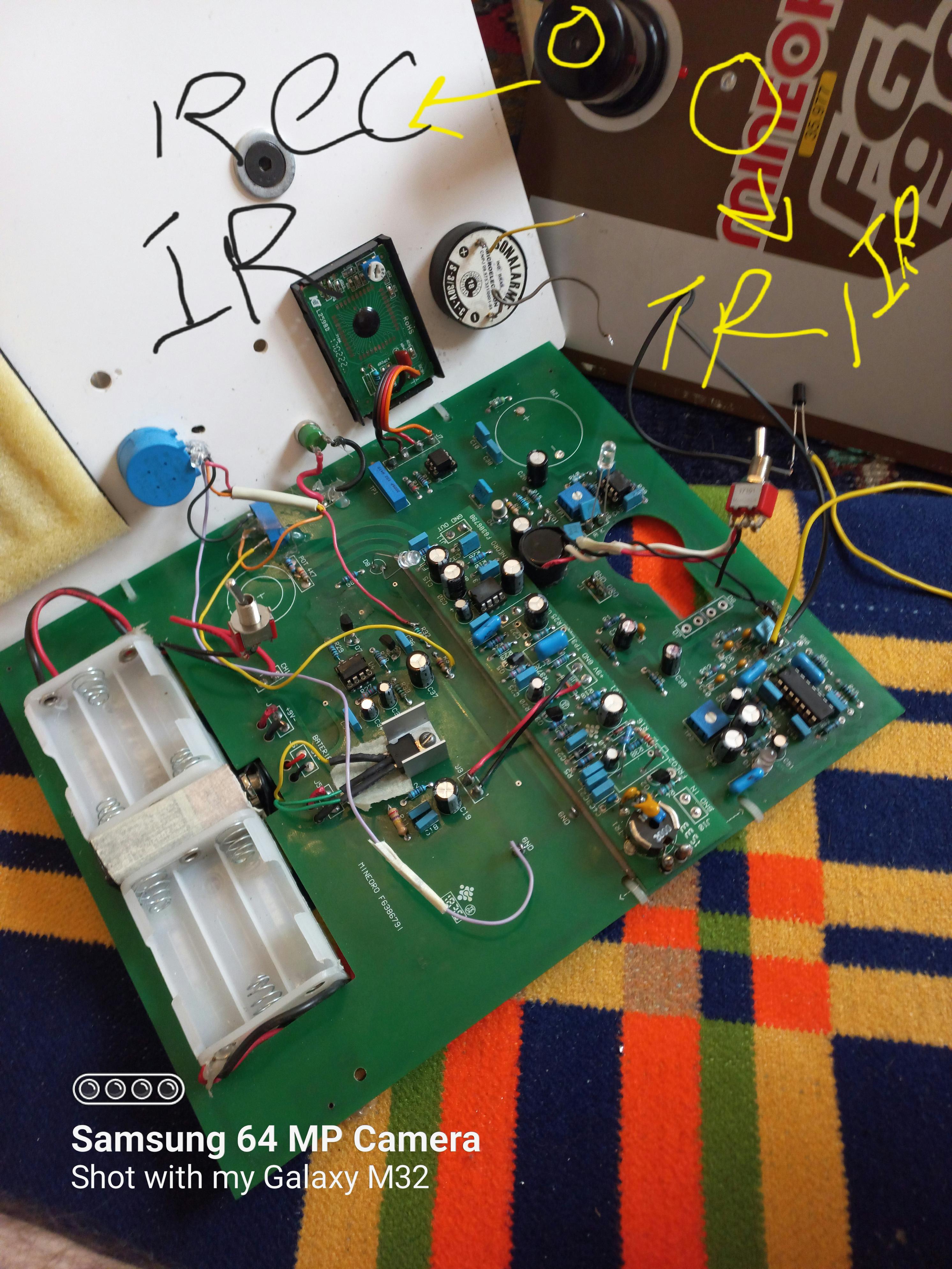

                    I attach the picture of my fg 90 and IR reciver
                          Thanks for sharing the photos, very interesting the circuit of the FG90 we have never seen the inside of the FG90 before.. I see an optical detection system and a magnetic detection system.. I think the ion chamber has been replaced with an IR circuit I think it does the same job better I guess..the magnetic circuit is in many models the same as in this one..we have seen many times before the same things 2 in 1 systems from the manufacturer similar. the IR receiver circuit is interesting if you wish you can share it with me and tell you some details about the systems handling.

                            My device is defective and I do not have access to the manufacturer of the device. I just want to repair and calibrate my device. I would be grateful if anyone could help me.

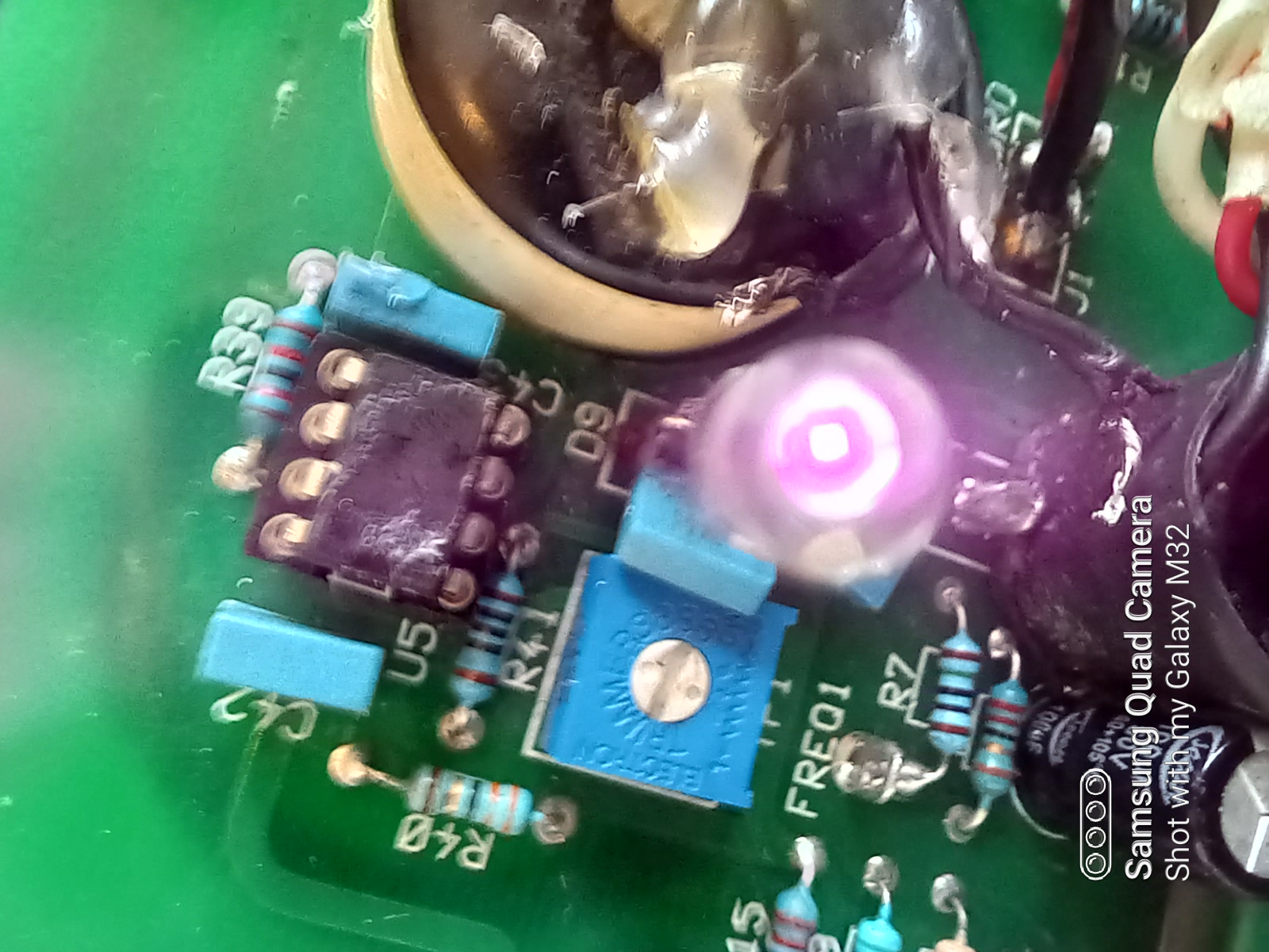

                            The regulator ic was defective, and this problem was caused by the device's PCB, which had a short circuit. The 2646 transistor was defective and the LED inside the ion chamber is also defective. I did not open the inside of the ion chamber, but if I have to, I should open it. I don't know what kind of LED is inside the ion chamber. I have a problem with the frequency of the ion chamber. In practice, the ion chamber does not work. There is a frequency of 774 Hz at the head of R7, but then the resistance of this frequency is destroyed by the ohm of R7(1m ohm). I think the ion chamber frequency should not be 774 Hz. In the ORG pin, when the ion chamber is not connected, there is a voltage of 14.9 volts, but when I connect the ion chamber, this voltage decreases drastically.

                              Since there is no short circuit protection, all LED types of your device are burned out. In addition, it affected the magnetic receiver. First, make the magnetic receiver card independent. Remove the sensor IR RX leads and measure at the diode level (+-1800 will be seen). Then replace it with a new 555 one.

                                I already replaced IC 555 . But what type of receiver should I replace? 700 or 1000 nm? The infrared frequency of the transmitter of my device is 153 HZ with 7 volt. My ion chamber freq is 864 HZ .
