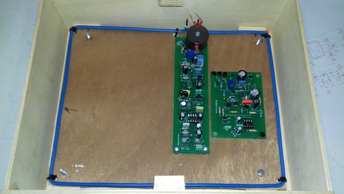

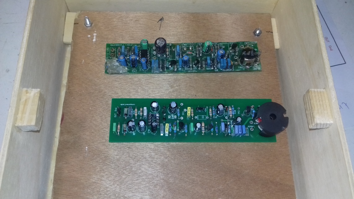

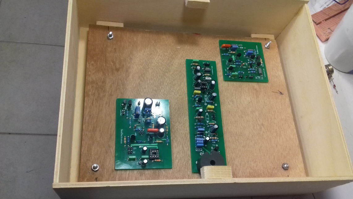

            I start to construct a modified clone of Fg80- FG90.
            Clone will have more power (sensitivity) than original one.
            Because i am sure that ion chamber don't makes nothing i will put a simple electric field detector at place of ion chamber.
            Now i give you a photo of box withsome pcbs and later will give more photos.
            • At this photo you see the original FG80-FG90 pcb and my modified pcb.

                        • The antenna loop
                          • is perfectly geo
                            but with aluminlum antenna you have more lowest disturbance
                            • There is n't any problem. Antenna wire is 4mm^2 so resistance is very low.
                              From the other side this project is a clone very close to orininal FG-80 with some modifications for better sensitivity. Also in place of ion chamber i use a sensor for catching the electric field.
                              Another one trick that will has this project is a modulated UV radiation as the FG90.
                              I must note that DC2008 (i don't know what is happening with DC2006) FG80 and FG90 have exactly the same receiver with only difference the working frequency. Also FG90 has a small and simple type of magnetometer that don't doing nothing.
                              • HI GEO
                                I AM THINKING THE RECEIVER IS VERY WEAK ONLY THREE TRANSISTOR !!!
                                MAY BE THIS IS BETTER TO CHANGE RECEIVER STAGE
                                BEST REGARDS
