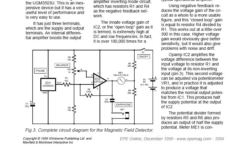

        • December 99 was another magnetic detetector.
          I think the one Esteban posted was using a power supply transformer as sensor and claimed to detect a train kilometers aways, i d´nt know if it was an electric powered train or detection was of the moving metallic mass, what would be amazing.

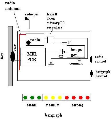

            Hi Esteban.
            Thank you.
            Some questions yet.
            Does The antenna of radio must connected to c1 or must be a wire near the loop???
            I suppose that i must use different power supply for radio and MFD.
            At who frequency must tune the radio???
            My Regards
            The cable or wire near the loop is the radio antenna, this is independent.
            This is another dispossition, audio of MFL don't go to radio pot, both audio go to beeper circ. independent!
            HOW TO TEST: put near the loop an electric clock, at each 1 second pulse led brights and beeps sound is present. My loop system is very free of interference, obviously with few ohms coil.
            I try it in 4 or 5 variations and ALL works good.
