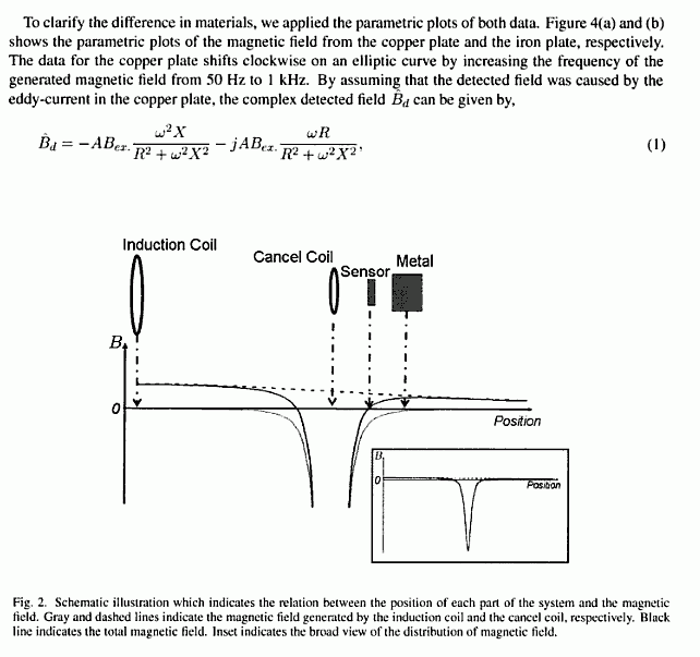

By typing in the title on Google, I found enough of the article here via Google Books that explains the tests with a schematic and graphs of the results. Wow, very interesting and nice to have a new idea for our hobby.
to g-sani
the article says: A new type of magnetic field detection system, which can operate at a frequency below 1 kHz, is proposed and developed. The system consists of a 40-turn-coil to generate the magnetic field and a magneto resistive sensor to detect both the amplitude and the phase signal of the magnetic field induced by eddy-current and magnetization of the samples. The magnetic field detection of ferro- and non-magnetic samples using the system is demonstrated and discussed.

Hi epitopios.
There is no circuit shematic showing components or values.
The designers from the Okayama University gave this vital information that explains the technique to discriminate metals:
