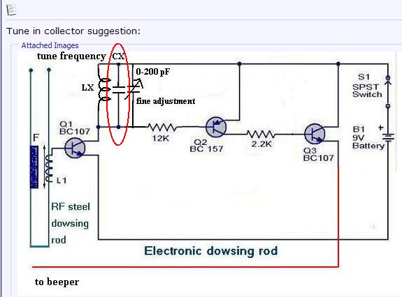

      do you mean 80mhz? because 80khz with a 200pf cap will give only a very small tuning range, and wound on air it will need an awful amount of turns...
      Supossed you use for to tune it 2 capacitors, one of 4n7 and other of 3n9 (CX, THE BOTH VALUES ONLY AS EXAMPLE). Sometimes for to tune exactly you need some pF, sometimes less 200 pF, so this is a factor of fine adjustment. Maybe is not necessary.
      For LX maybe you need 500 turns of wire 0.15 mm in small form. But you must calculated it.

        80Mhz is so high frequeny.
        200pf needs 20mH to tune at 80Khz..... and 20nH to tune at 80Mhz.
        Nothing is good
        Geo, see CX + pF. Of course, you don't need mH is you use higher cap. for CX. pF is fine adjustment factor.
            I see.And i like you example
            • #36
              Very simple: you have capacitors 4.6... 4.8... nF, 3.8... 4.0 nF... 4.1 nF... never is exactly. I use in example because in a round coil 16 cm diameter 30 turns wire 0.35 resonates at such frequency with 4n7 and 3n9 + pF. Everybody knows that all capacitors marked 4n7 hasn't 4n7... 3n9 hasn't 3n9... just approximations... But if with these capacitors you obtain less than 80 Khz, then remove turns of wire. Of course, all is patience.

                El. Rod
                Here you are real, complete, easy to build and working schematic. No empty block diagram.
                Schematic represent kombination of (rost free) steel U shaped dowsing rod with electronic sensing amplification tuned on target resonating frequency. Dovsind rod data: rod (steel wire) diameter 4.5mm, lenght 45cm, distance between U shapped rods 45mm. Ferrite rod antenna (F) have to be fixed (glued) at 4,5 x inner rod distance from both rod junction (at about 20cm). Coil is tunable to resonate on different target (have to be tested on individual final construction). It is suitable to pistol forming construction. L1 = 180 windings Copper enameled wire 0.2mm on plastic tube inner diameter 5mm.
                Are you sure C2 is 0.1 uF electrolitic ? In my country not exist this value ,yes if ceramic capacitor...
                • #38
                  Yes, there is such a thing as a 0.1uF electrolytic capacitor, at least there is in tantalum format. I have some at home.
                  However, I cannot see why it would need to be a polarized capacitor. Simply replace it with a 100nF cap.
