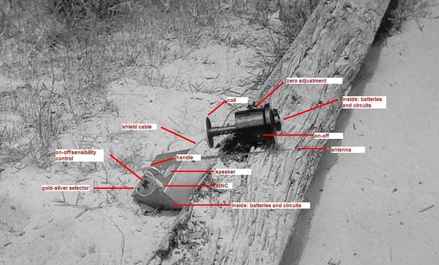

IN 1980-81 (B & W PHOTO)
  • #16
    Before emit the BFO an only hertz, the amplification enlarge this "soft breeze". With this type of detector (I had one of 80's generation) I found a copper plate 120 X 60 cm (very big) at 50 meter distance and 1.5 meter depth with a coil of 11-12 cm diameter.
    The old coil I saw was turn by turn, but other models has classic winding. The BFO is a transmitter since is an oscillator and at the same time is a receiver, so attention with the "obsolete".
    Here exactly the middle and the end of 80's pistol I had:

        hi
        Hi Estebanif this pistol detector is a kind of BFO
        where is the reference oscilator coil?
        and why why there is a antenna in radio part.
        and does it work when it is turned to ground(what we do when pinpointing with mineoro)I wonder its dept penetration in this position.
        • #19
          Hi, the reference coil is in the black head.
          In the radio is the called "classifier".

            • #21
              Search coil is the front, the circuit is in the black head, include the fix oscillator with his coil. The zero is make with precise tandem. This circuit is linked to the aluminium box with the shielded cable, in where is the radio and classifier control with potentiometer.
              Variations there are severals, but the principle is equal in the major part.
