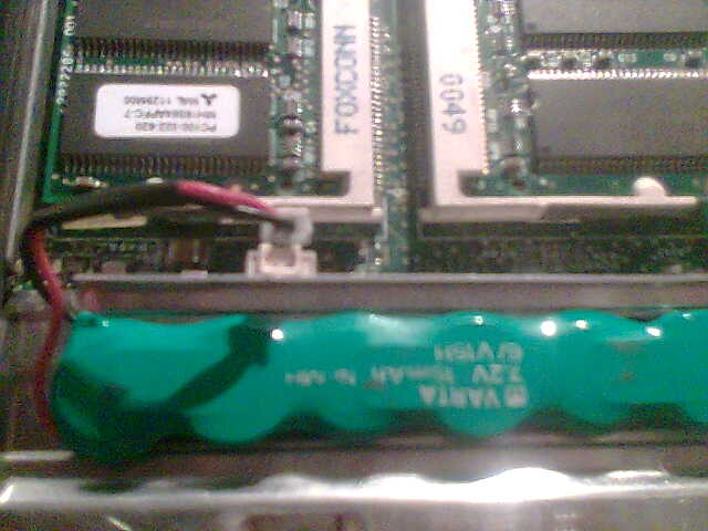

            The easiest way is to open the back of the laptop and remove the CMOS battery, and leave it out for several minutes. When you put it back, the BIOS will have been reset.
            If this is a more modern laptop, it may have a security chip, and removing the battery will not work. Depending on the chip, you can short together certain pins, and that will reset the BIOS.

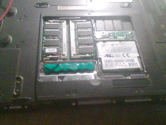

                bios
                What is the make and model of the laptop?

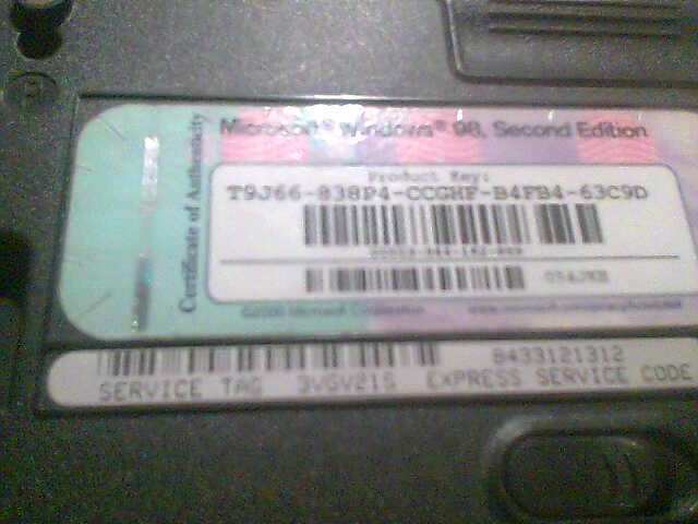

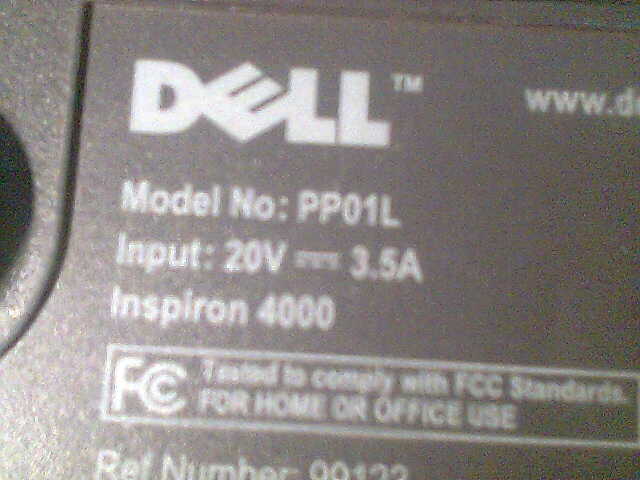

                hi qiaozhi sorry iwas out door for hunting. this is image back side of laptop

                  bios
                  whos the ic wiil be reset

                    There is a program here that will calculate the master BIOS password for Dell Latitudes from the Service Tag number -> http://www.users.globalnet.co.uk/~sk...s/latitude.exe
                    You need to open a DOS window (obviously on a different machine) and enter "latitude 12345", where you replace 12345 with your service tag number.
                    I also read somewhere that you can use a backdoor BIOS password. Trying entering "Dell". This is claimed to work for some Dell machines.

                        About the "latitude.exe", you can save it wherever you want, but you need to run it from the command line.
                        It wants a 5 letter service tag number - yours looks longer than this.
