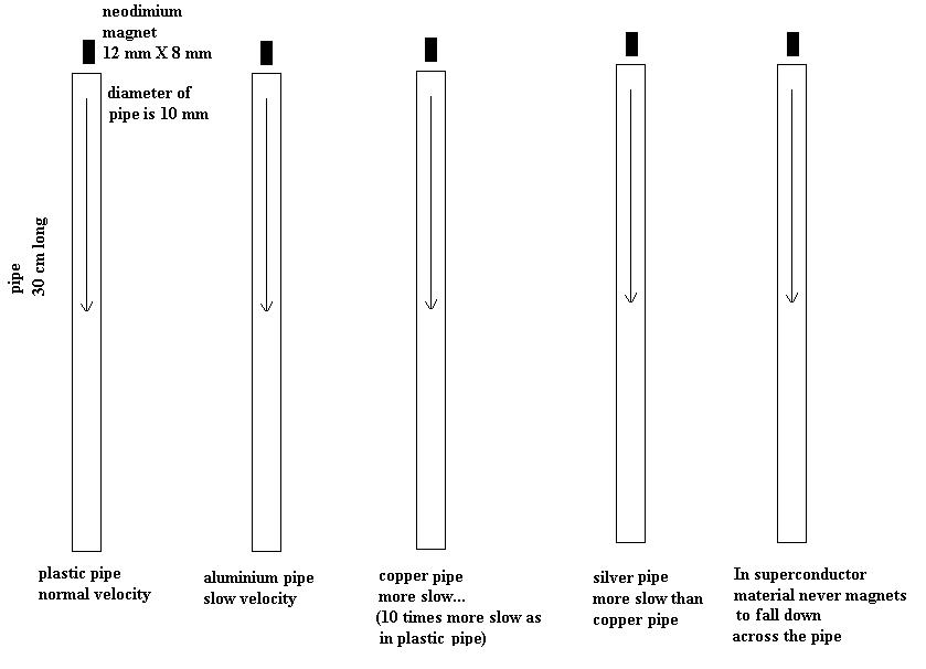

Is not friction.
WHAT CAUSES IT?
Which one are you asking about?Originally posted by Esteban View PostIs not friction.
Let's discuss the copper pipe, as it's really straightforward to explain.
As the magnet falls down the pipe, due to the action of gravity, it induces eddy currents in the copper wall of the pipe. This current, in turn, generates it's own magnet field that opposes the field of the magnet, this causing it to slow down. The same thing is going on in the other non-ferrous metal pipes.
As for the plastic pipe - that should be self-explanatory.
I don't understand your comment about the superconductor. What happens there?
I'm guessing that, due to the Meissner effect, the magnet never falls to the bottom. Is that what you're saying?
If pipe is made by superconductor magnets never falls.Originally posted by Qiaozhi View PostWhich one are you asking about?
