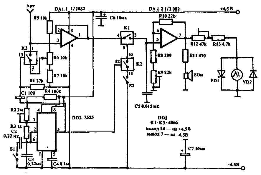

Hello friends of the Forum, does somebody have the text of the Sahori41? I am wanting to arm a remote censor.
And if some of you have a good diagram that he/she wants to share with me he/she would thank them a lot.

http://radiotech.by.ru/Shematic_PCB/...biolokator.htm

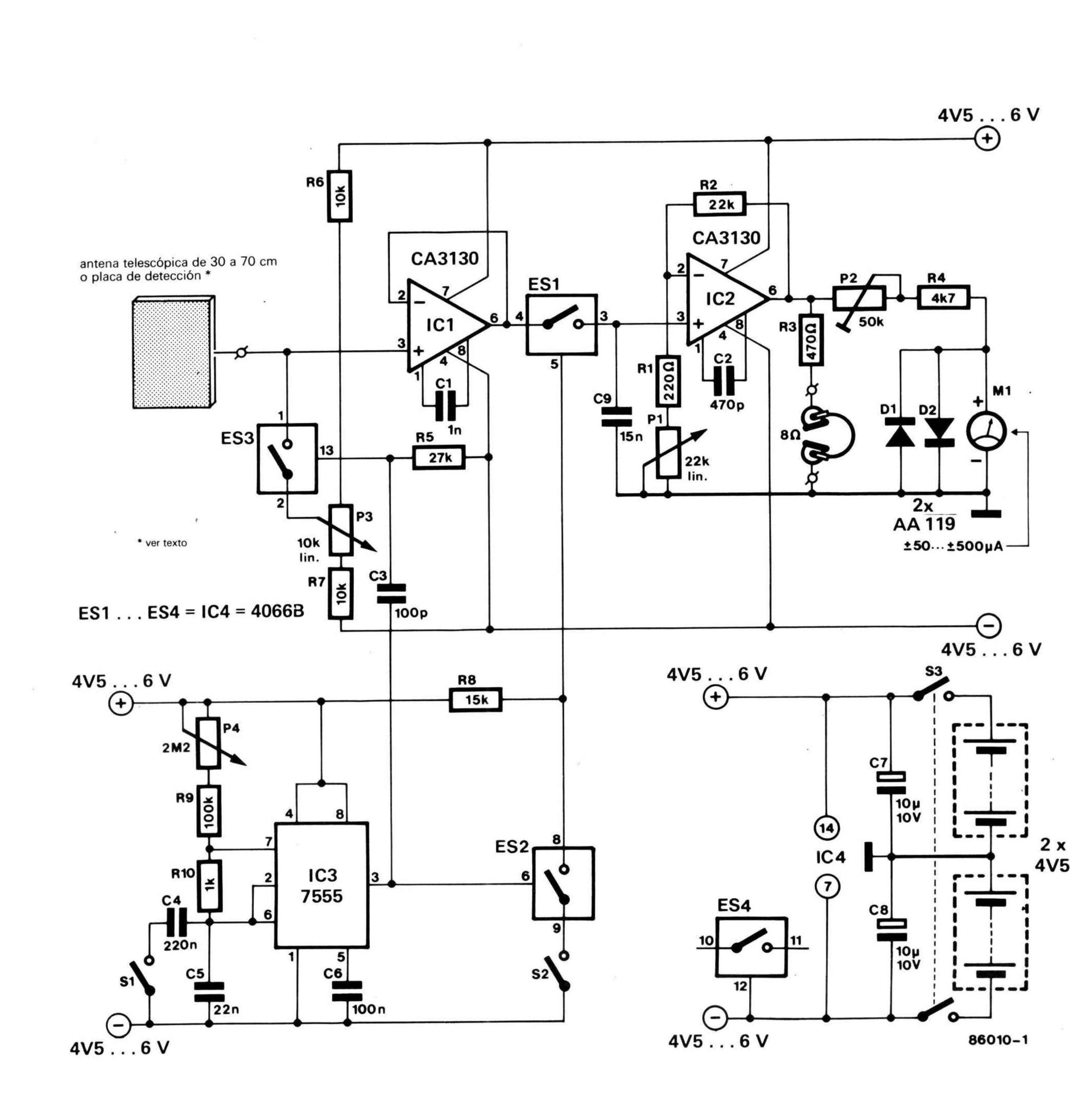

NJoseph:
The circuit of the Russian web posted as "Electronic Biolocator"
http://radiotech.by.ru/Shematic_PCB.../biolokator.htm
is the same of the original schematic by German issue Elektor (1987), published in Spanish as "ZahorÃ* electrónico", means a device for to locate water electronically by interchanging ions principle. Compare the both schematics. Are the same!!!
El circuito del sitio web ruso como "Biolocalizador Electrónico"
es el mismo que el esquema original de la revista alemana Elektor (1987), publicado en español como "ZahorÃ* electrónico", que significa un aparato para hallar agua bajo el principio de intercambio iónico. Compara los dos esquemas. ¡¡¡Son iguales!!!
