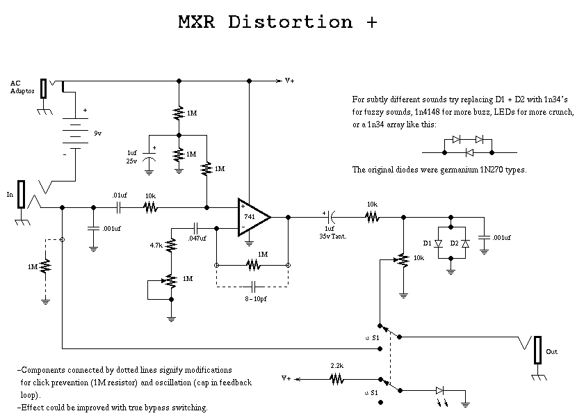

Old 01-04-2011, 09:28 PM
You shouldn't.
Wrong answer.
Not high tech. Actually low tech and very simple. Yet effective and millions were sold.
Aren't you one of the 'eyeballers' here who can spot a circuit schematics and tell their 'lifestory'?
Try again. What is this?
When you see this smilie -> ... it means "sarcasm".
Of course it's low tech. I was being SARCASTIC.

(...)What is this?
Let's hear the ' geoskepthic engineers' speak.
This looks like a $10.000 device to me

What is this?
Several hours have passed and the eyeballers could not even tell what this circuit does, much less what device this is.
I will help then.
The purpose of this was to demonstrate how speculation about something can be thrown by people at anytime in hopes that it 'might stick' when the true explanation is unknown to them.
This is a very simple circuit, nevertheless the electronic engineers here did not risk any takes as to prevent them to comit a mistake because they simply do not know about it.
So, regarding the CDM210, by simply stating their lack of data for deeper analysis about the schematics wouldn't be a much better, safer, prudent and honest attitude, instead of speculating in a pejorative way?
How can someone rush to create wild conclusions and wrong judgements about a device when not even the schematics is well understood by them?
Well, I hope this example be remembered.
Even with a simple schematic provided, some people here with knowledge in electronics were not able to identify a famous distortion stomp box used by guitar players in the 70's or tell what the circuit was supposed to do.
