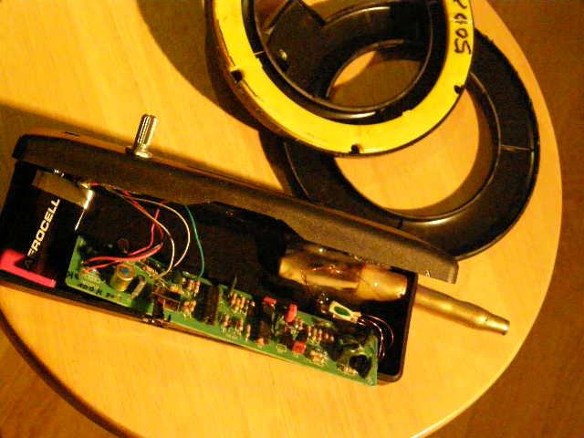

I have made some changes in my (ferrite coil) pinpointer to convert it in some sort of magnetometer that can show phenomena as seen on Geos video.
There is only small mod, no hidden switch, no moving switch and no magic trick.
And get phenomena presented by Geos PD. Look at video:

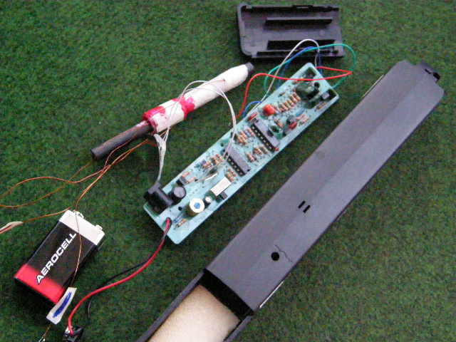

Probably nothing special to share, Zocky.
My pinpointer is made out of personal security detector (eBay, China, 4$+p&p).
In first line i replaced original air core coil with new wound on ferrite core.
To put pinpointer that work as some sort of magnetometer we need a minor additional mod.
I have no scheme and am not willing to draw it, but if you purchase the same thing, I can give you all data for mod needed to get the same results. Look at photos:

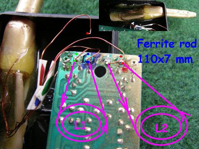

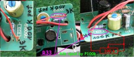

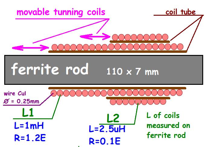

Hi Nelson,
if you or anyone wish to try, here all data needed:
I moded Security handheld metal detector model: LT-88B, producer ZhangFei, China.
Air core coils was replaced by on ferrite rod wound coil (following to keep the same inductance).
Coils data (measured at measuring frequency of 10kHz):
L1
Inductance L=1.0mH
Resistance R=1.2E
Impedance Z=62E
Quality factor Q=54
L2
Inductance L=2.5uH
Resistance R=0.1E
Impedance Z=0.18E
Quality factor Q=1.5
Wire used for both coils: enamelled copper wire 0.25mm (AWG30 or AWG31). I do not remember how many turns was wound, so you have to follow inductance, which is more correct, cause you very likely do not have the same ferrite rod.
Coils have to be tuned on maximal sensitivity by multi-direction moving both coil to reach the best position, then fixed and glued by composite resin.
R33, originally 3kOhm, was replaced by potentiometer (by which we can turn detector in Earth-magnetism sensor) of 100kOhm (look at picture).
That's all. Enjoy sensing our lovely Planet.

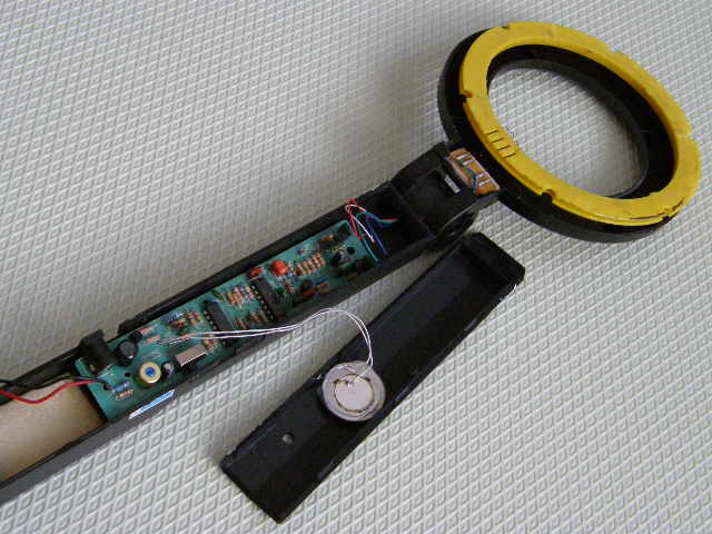

Hi WM6,
Thank you for the infos.
This is the best presentation to show how to mod an experimental LRL that I have seen.
It gives ALL of the information needed with easy to read diagrams.
We have never seen such a well written LRL project in this forum.
Of course, other kinds of LRLs are more complicated, and may require more difficult details.
But hopefully others will notice your exceptionally good presentation and pattern their posts for mods to be similar.
Thank you for a job well done.
