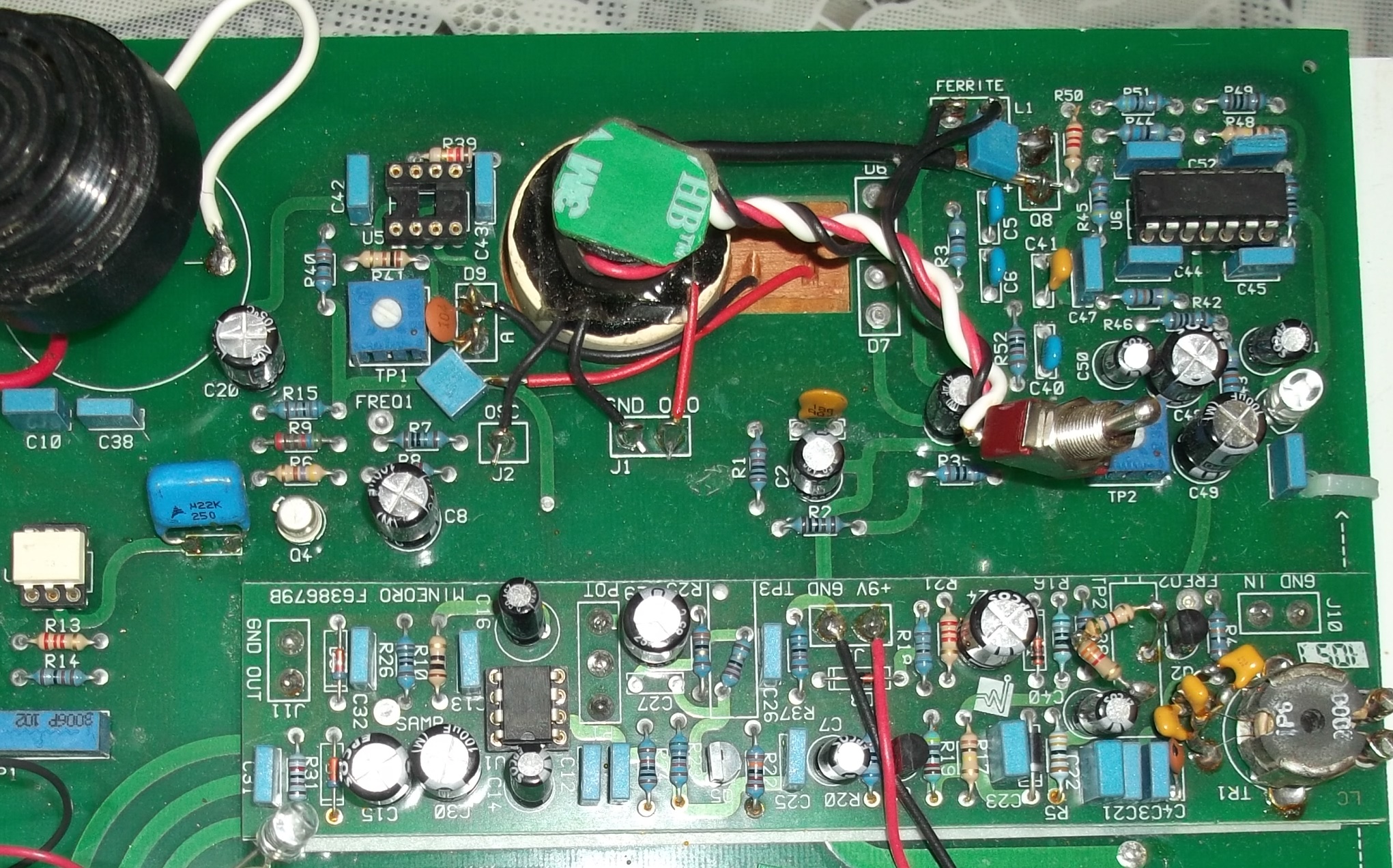

Join Date: Sep 2015
Posts: 21
Thank you Geo.
Here is a picture of the ion chamber area, all their baseline IC are cleared as the photo shows.

I measured the voltage between the pins 1 and 8, I found 9.70 V.
Also you can measure at pin1 and pin4, must be again 9.7V. If yes then it is a 555.
I believe that it is an oscillator for an IR Led at front of pcb.
My opinion is that it is not neccesary to connect it.

Old 10-22-2015, 04:15 AM
Behkli, can you tell me who is the capacity of 3 yellow capacitors beside the toroid coil??

RIMES RIMES is offline
Join Date: Sep 2015
Posts: 21
this device has been short circuited (poles inverted stack).
For yellow capacitors, the figures, I believe, are 103, 561 and 561 (very small).

Posts: 21
This is a full PCB of FG90

  #346
Old 10-24-2015, 05:26 AM
Thanks for photo of PCB but i need the component side.
Thanks

2 wires, one black and one red and they are go to the wood base of chamber. What is connected from the other side???
The 2 wires connected to the IR.

Old 10-26-2015, 05:34 AM
Thanks Behkli
I would like a better photo of soldering side at the place of U6.
Also where is connecting (near to chamber) the shielding wire (Q ?
Up of the chamber are there 2 coils (rf chokes) or one with center tap???
Do you have signal generator to test the receiver of FG90?
As i calculated it is tuned at 34.5 Khz
