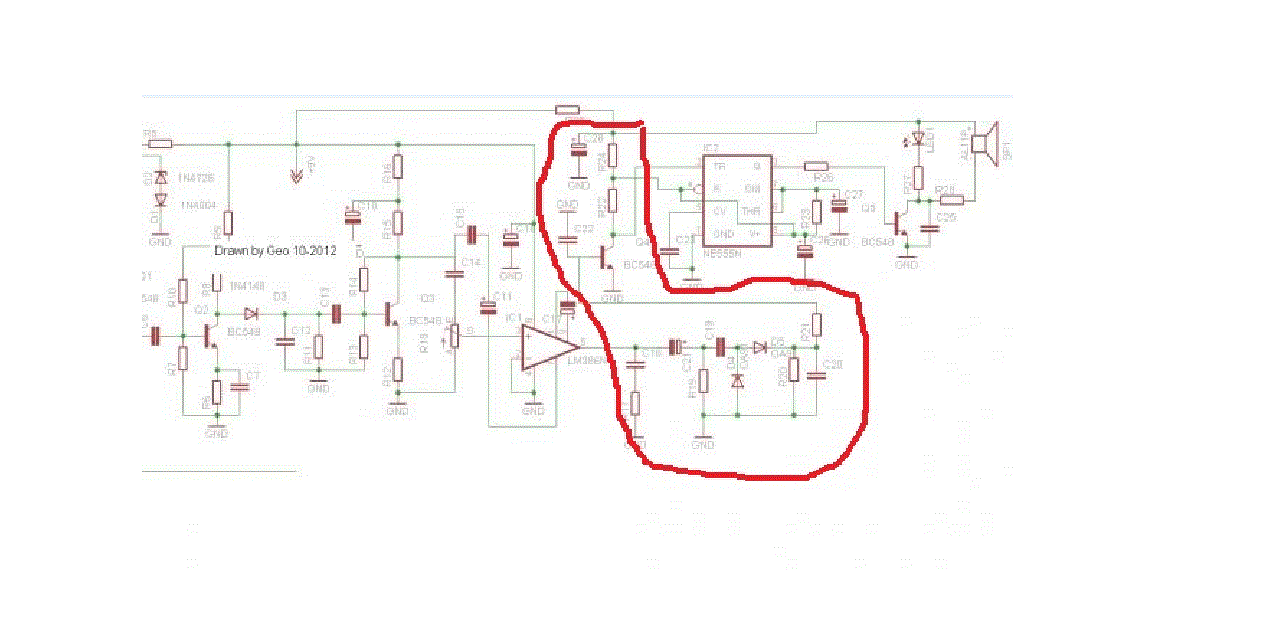

Thank you, I am missing the values between the audio amplifier and the beep generator if it's not too much to ask
Can you post this schematic?

excuse me my friend, but I don't, I use my own scheme
I said the schematic in the picture

I do not have the values of the components of the diagram, I use another receiver

I can't answer without see the schematic of receiver....
It's Sony M-450 Microcassette Recorder with preamp and tranfo + beep generator

Old 01-02-2022, 06:36 PM
This has nothing to do with Mineoro MF receiver .
  #399
Old 01-02-2022, 06:39 PM
Join Date: Mar 2014
Posts: 1,050
what's the difference, what's special about the mineoro receiver ???
  #400
Old 01-03-2022, 06:10 AM
Maybe nothing special... but it is n't a tape recorder.
Preamplifiers of tape recorders have filters so to work according to the NAB curve.
