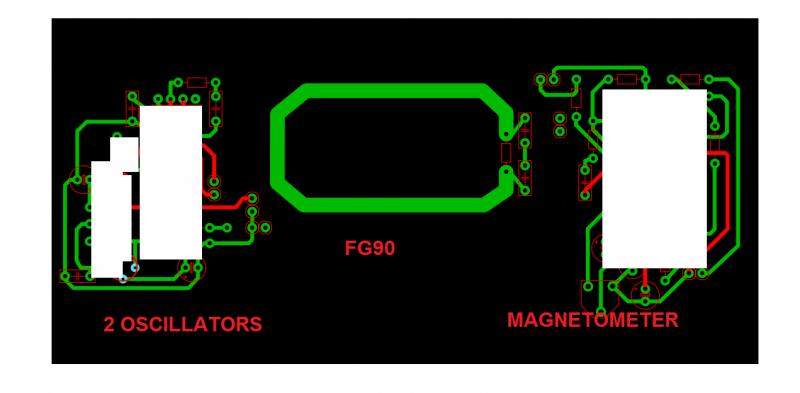

FG90

Posts: 1,050
Hello dear members of this forum, I noticed after several experiments and modifications on the mineoro magnetic receiver that it is necessary to increase the inductance of the ferrite cores and to add a preamplifier, this makes the receiver ultra stable and sensitive, I was able to receive any VLF signals from 1500KM distance at any altitude level even in underground caves.

hello abdou
I'm glad you were successful in your project.
Can you tell us about the working logic of fg90, for example frequency range, sensor stage, materials in the sensor or input, development, how the result is formed and similar diagrams?
thanks

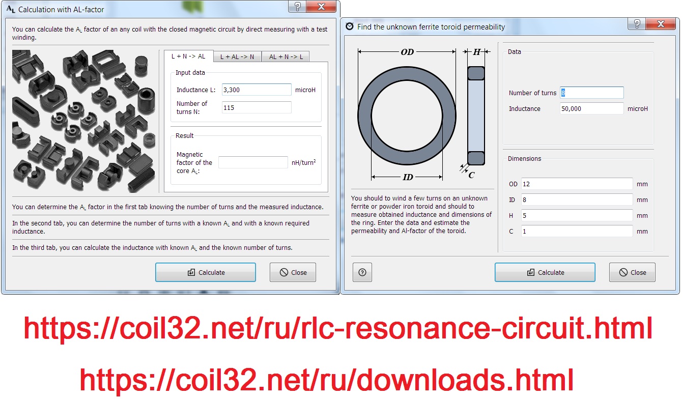

  #511
Old 11-26-2023, 07:26 AM
IP6 / 2000 is very good.
I took good results only when Al was 400 or more.
  #512

Posts: 283
FG90
Post full pcb and schematic you already have. No one can make a pcb withouth schematic.
And high resolution pictures of your FG90 pcb both sides would be fine.Than we would make conclusions what should be modified and how it would be.

Old 11-29-2023, 01:23 PM
Originally Posted by Dubulumach View Post
In Electronics must'n be belivers and dreamers. Only real things are valid measurements and calculations.
I agree.
All the art is the formula L=Al x turns^2

  #518
Old 08-22-2024, 06:11 PM
Join Date: Mar 2014
Posts: 1,050
I modified my FG90 and it work very well, what's your calibration details ?
