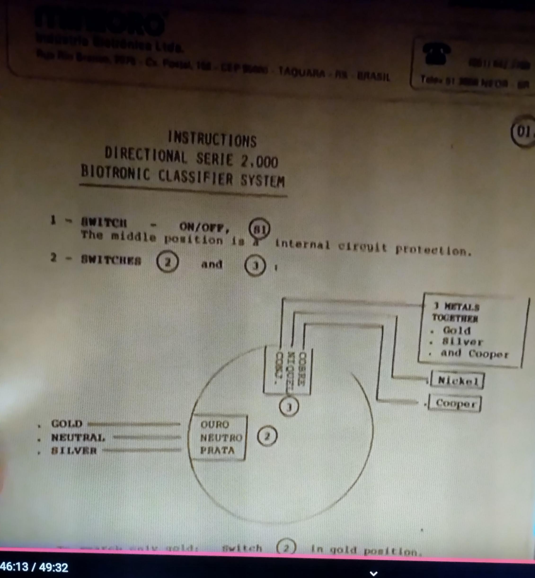

Posts: 102
hello everyone. in the pictures of the dch 85 there is a loop of thick wire that closes through a resistor and a ceramic capacitor. what are the prices of the components ;;;what is the diameter of the loop ;;;and is it connected somewhere ;;;;;

For anyone interested, the resistance should be 4.7 KΩ 5% yellow/purple/red/gold.
Capacitor is 150 nF and diameter is near to 4 cm. R as u wrote is 4k7. It is a passive filter and is n't connected anywhere.

Hello Mr. Geo. Thank you. I am asking about the diameter of the large loop that is in front of the head. To my eye, it looks like 10 cm-13 cm.

Are the two switches on the head of the dch 85 the samples?

It seems like it is .Inside the coils are metal samples, something like filters. But the size, number of turns, and weight of the samples are still a mystery.If you have such information and have the opportunity to share it here with the forum participants.

I don't have the information about the samples, I'm still looking for information. (Are the samples in wire form? Or is it the core for small copper coils?) Surely some people know, but the question is whether they will provide information. Until then, I'm continuing my construction with the data I have and I'll see in the hunt..if it can receive the signal I get with another LRL, it's enough for me for now.
