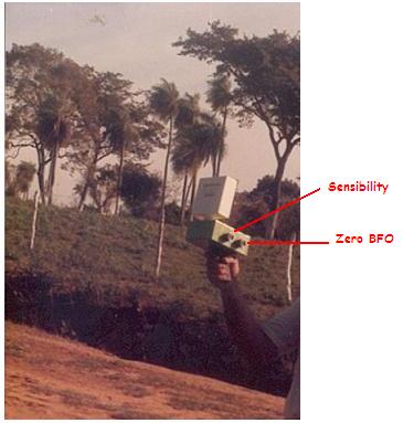

Close-up of long distance radar MD for gold and silver. Miguel MontanĂ*a Grinok (my cousin), with the detector. Many of the photos I'm colected have secuences.
The apparatus sometimes detect copper, nickel and bronze coins, but only at very short distance, two or three meters, but gold and silver coins, rings, etc., was detected at 30-50 m, and the depth is no problem, easily 2 or more meters. The only time I see to detect bronze coins at 10 meters from the detector had explanation: in the place we found 12 good quality bronze coins.

No, but basically is a stable BFO, radio, alarm, classifier... Here the crude parts:

After you said this device works with BFO ,I read some pdf file in geotech archives.ther it is told that BFO type detector are good in discrimination but bad in dept penetrating.generally 20-30cm .but you say it detects from 50m away and 2m and more dept.
Could you please explain how can it be.And trnsmitter(one which looks like hairdryer) coil looks different can you tell about its windings .does windings make it to affect farther and deeper.
thanks
okantex
Old 09-04-2006, 06:48 PM
Before emit the BFO an only hertz, the amplification enlarge this "soft breeze". With this type of detector (I had one of 80's generation) I found a copper plate 120 X 60 cm (very big) at 50 meter distance and 1.5 meter depth with a coil of 11-12 cm diameter.
The old coil I saw was turn by turn, but other models has classic winding. The BFO is a transmitter since is an oscillator and at the same time is a receiver, so attention with the "obsolete".

The detectors showed here has normal coils. I never see another kind of coil, example type spider.
Works like a radar, but detects microvariations in the adjacent ambit.

Hi Estebanif this pistol detector is a kind of BFO
where is the reference oscilator coil?
and why why there is a antenna in radio part.
and does it work when it is turned to ground(what we do when pinpointing with mineoro)I wonder its dept penetration in this position.
Old 09-25-2006, 04:15 PM
Hi, the reference coil is in the black head.
In the radio is the called "classifier".
Old 09-26-2006, 05:53 AM

if refrence osc. in black )also beat osc must be in bleck because it is the one we use in bfo),so what is the antenna for in radio ?
clasifer must get signal from beat osc. ,if not what is the cable for between black and clasifier?
Old 09-26-2006, 06:22 PM
Search coil is the front, the circuit is in the black head, include the fix oscillator with his coil. The zero is make with precise tandem. This circuit is linked to the aluminium box with the shielded cable, in where is the radio and classifier control with potentiometer.
Variations there are severals, but the principle is equal in the major part.
