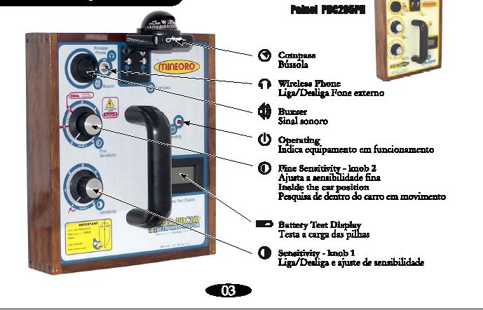

The "dissected" is the microcontroller version with an only potentiometer.
The PDC 205 and PDC 210 with two potentiometers that works in the limit is extremely sensitive. VERY. I agree the microcontroller/semiautomatic version (early PDC) is not good...
I don't know the performance of the 428 (in Dell's hand).
In this photo you can see the both knobs.
So, Carl's report is about the early microcontroller 1 knob model (several years out of the market).

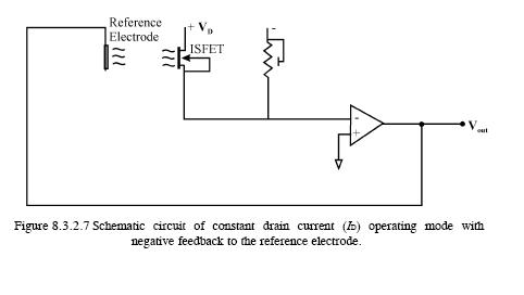

Detection of ions (molecules in movement) can be selected. Ionic selective detection is a reality and today exist special fets called ISFETS wich detects ions and substances. In accord to Scientific American:
The R&D effort started in late 2001, when Koehl, an electrical engineer, arrived at Cambridge from the California Institute of Technology. "From the beginning, I had the idea to create a small, cheap chemical detection system for the military and Homeland Security and then, later, for commercial markets," Koehl says. He soon met Boyle and Ruiz-Alonso, and during the next months, the engineers looked at a lot of sensor technologies, "trying to evaluate what we could take to the next level," Boyle reports.
A chemical sensor "is essentially a filter device," Boyle explains. "Each substance has its own signature smell or fingerprint. That's what we filter out." For Owlstone's sensor, the team chose to develop a relatively new and little known analytic technique called high-field asymmetric waveform ion mobility spectrometry (or FAIMS). The approach sorts compounds according to how their charged forms--chemical ions--move through a gas when subjected to electric fields.
As the ions are made to pass between charged metal plates, varying electric fields (that is, the asymmetric waveforms) drive them toward either side and back again successively, eventually causing most of the ions to hit the plates. But careful application of direct-current voltages to the plates keeps targeted molecules from hitting the sides until they reach a detector at the end. Each DC voltage correlates to an ion type, so the device can be "tuned" to detect specific substances.
More info here:
http://www.sciam.com/article.cfm?art...6883414B7F0000
But this technic is not new. Another technic (no new) uses an oscillator at typycal frequency of 10 Mhz. This technic is called:
Quartz crystal microbalance (QCM)
A quartz crystal microbalance (QCM) sensor comprises a quartz crystal coated with a chemically-selective film. The crystal is configured in an oscillator circuit and typically has a base frequency of 10 MHz. When vapours from the sample interact with the coating film, some are absorbed, causing an increase in the mass of the film. This in turn leads to a decrease in the frequency of the sensor and this is measured as the response. The frequency shift is typically about some hundred Hertz. The advantages of QCMs include high selectivity, high sensitivity, stability over wide temperature ranges, low response to humidity, and good reproducibility.
This technic was used in airport for to detect explosives. For example, tissue of the skin of X reptile is placed in a one face of the crystal and the few molecules of explosive (one part in 200,000,000 parts of molecules of air) can be detected.

1. 2 potentiometers no mean that all Mineoro's models have the same electronic circuit.
2. The next mean: the rain causes disperssion. 2 or 5 days after the rain, Mineoro recover his capability. So, they need that you and your witnesses to stay 10 or 15 days in Brazil, because sometimes there are many rains. This is part of his condition:

3. For Mineoro, LRLs no mean DOWSING RODS. Mean: Long Range Locator, in this case electronic long distance detector:
We would like to make clear that we are going to claim your challenge as two different companies, Mineoro and Segmax, with two different LRLs, and when successfully completing the tests, you will have to pay USD 25.000 to each of the different Claimant companies.

3. No traditional metal detection, magnetometry, or radiation detection is allowed. The test is limited to the LRL only.
In the case of Mineoro's electronic devices, the Standard Test Protocol is not applicable, because is a kind of radiation detector. (If we consider Mineoro works as ionization chamber.)
In accord to this point 3., Carl accept the existence of another kind of metal detectors with the capability to detect at X distance.
I think there are confusion respect dowsing rods and electronic long range locator. Obviously, the "treatment" is not applicable for Mineoro's electronic devices, this is PDC or another similar Mineoro electronic models.

The two examples of ion detection that you cite both require the ions to physically contact a sensor, which exactly support my point that the Mineoro claims of remotely detecting ions are unlikely.

CARL YOU ARE INSISTING THAT THE IONS HAVE TO BE DETECTED AT A COLLECTOR PLATE,INSIDE THE MINEORO IONIC CHAMBER THERE IS A ANTENNA OR ANODE WHICH COLLECTS THE IONS ,AND BE SURE IONS DO GO THROUGH PVC PIPES WHICH IS WHAT THE MINEORO IONIC CHAMBER IS MADE OF.
ELECTRIC FIELDS AND IONIC FIELDS GO THROUGH PLASTIC AND PVC.
