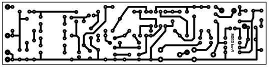

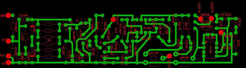

Old 03-21-2008, 01:07 AM
Hi Alex,
You can find here the PCB.
IT shoudl be re-verified, please let me know if there is mistakes or improvements.
Hope the shape of PCB is OK for you
Highter definition files zipped .
Happy building,
Regards,
Old 03-21-2008, 10:17 AM
Alex Alex is offline
Posts: 14
Smile great WORK
Really thanks Fred.
Yes the shape is perfect what we need.I will control the pcb tonight.
I want just to thanks you again you did in so short time.
Greatings
Alex

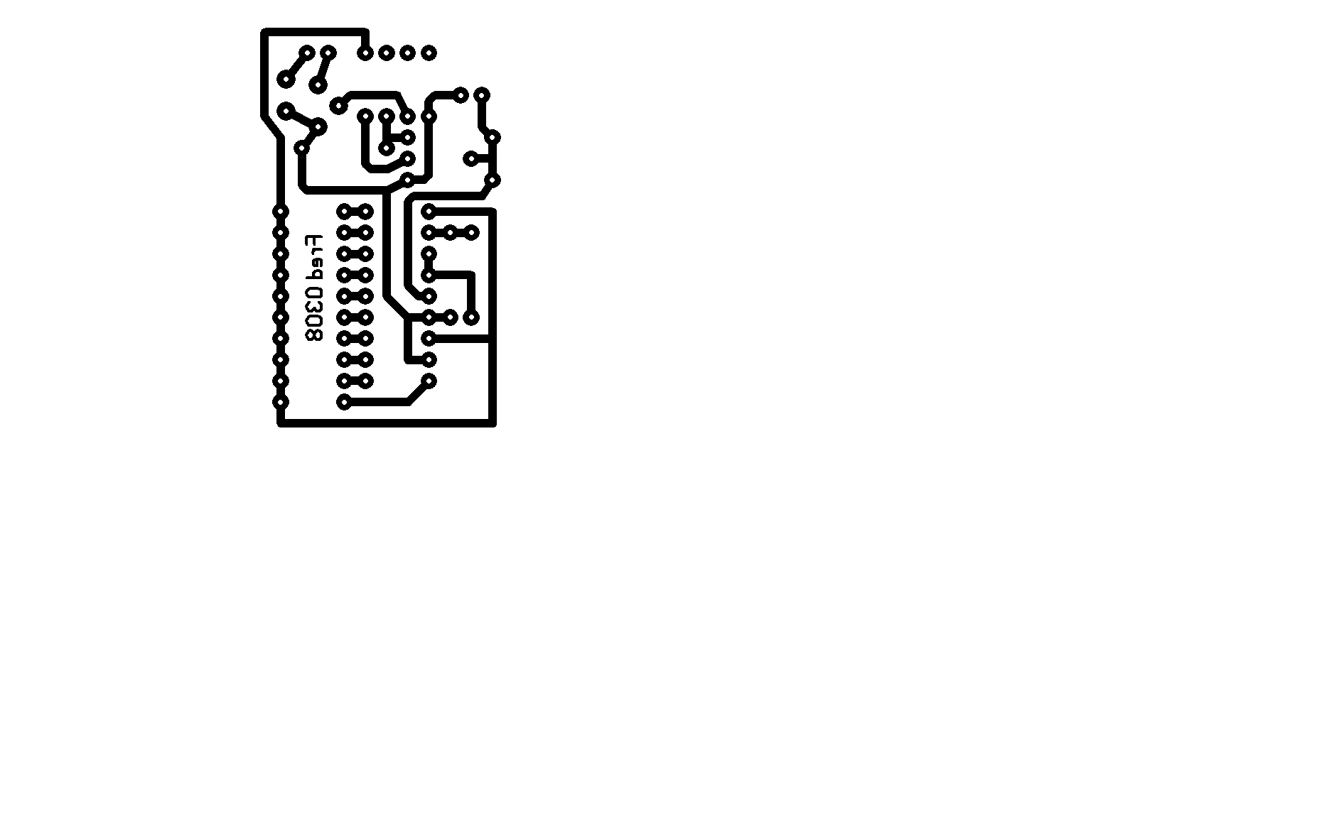

Old 03-22-2008, 01:15 AM
Here is a PCB for a sensitive vu-meter that use led row.
I have built it, i works fine.
Hope it helps!
regards,

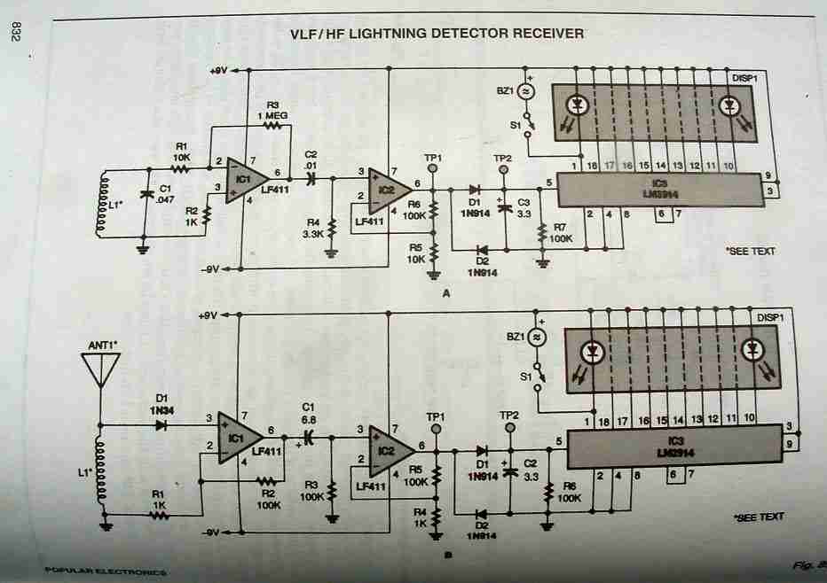

Old 03-24-2008, 02:48 PM
An interesting circuit...
Regards,
Old 03-24-2008, 03:01 PM
Regards,
I hope the antenna is not mounted on a long pole, otherwise you could get more than you bargained for!

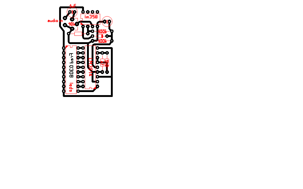

Fred in your Vu meter there are 3 components with name missing.Please add the name so we can make it.Thanks

Old 03-24-2008, 09:14 PM
Hi Alex,
Sorry,here you go.
Also includes a different PCB.This one use individual leds.
Regards,
Old 03-25-2008, 02:33 PM
I saw an old project for a storm detector in old "modern" mechanics maybe... but the risks are about the same!
Like the X-ray and laser projects... it seems good to toast something... or someone!
