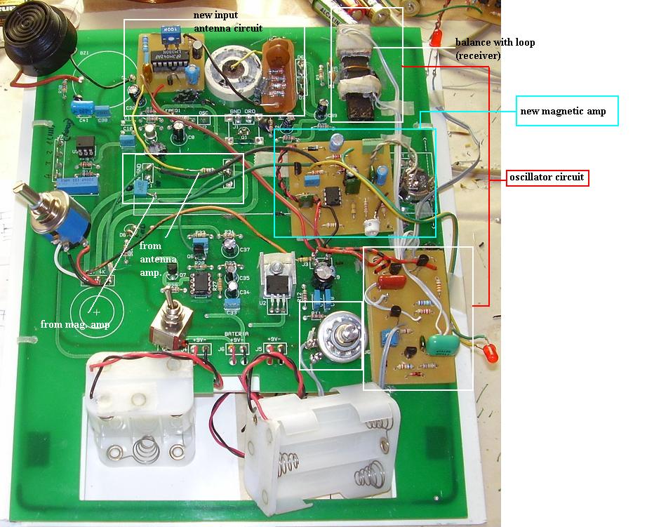

If the owner allow me, i will connect a switch in series with "ion champer" so to ensure when it detect an object, what is this that locate it, the ion champer or the passive receiver or both. If the champer don't doing anything (as i believe) then it is very easy for everyone to make a clone.
Check this modifications on DC2008 by Esteban :
Name:  DC2008,modificated by Esteban.jpg

This modification made by Esteban so to locate fresh objects from small distance. If champer don't make anything (i am sure) then Mineoro is a simple pistol as PDK inside a beutiful box and at a very very high price. I am curious what will happend if i"ll connect the loop with the pot core at the input of PDK

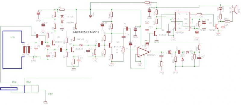

Here is the schematic from the receiver of DC2008. For begining there are not values of the components but i work for it and for the full schematic.
Enjoy
Old 10-10-2012, 09:52 AM
This (front-end) remind me on some Gardiner MD design.
Though, as far I remember, Gardiner use Hartley in his design and here is Colpitts.
The oscillator of DC2008 has at emitter of oscillator a signal of about 100mv. I think that it is a big signal for a receiver of this type. It need a strong signal so to see it as "anomaly" at the output.
