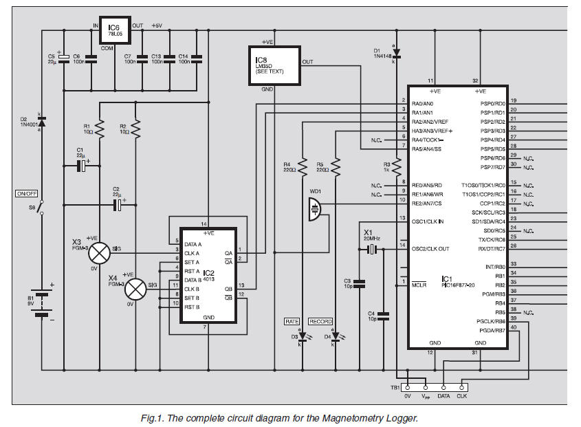

the best magnetometer
Old 05-29-2013, 04:59 AM
Not so sensitive magnetometer.
Also the FGM3 are very sensitive when you change the direction....

thanks geo
Do you think it's good circuit
Old 05-30-2013, 04:49 AM
You need more gain, ac coupling good calibration and...

thanks geo
IC 3 must change the ؟؟؟
