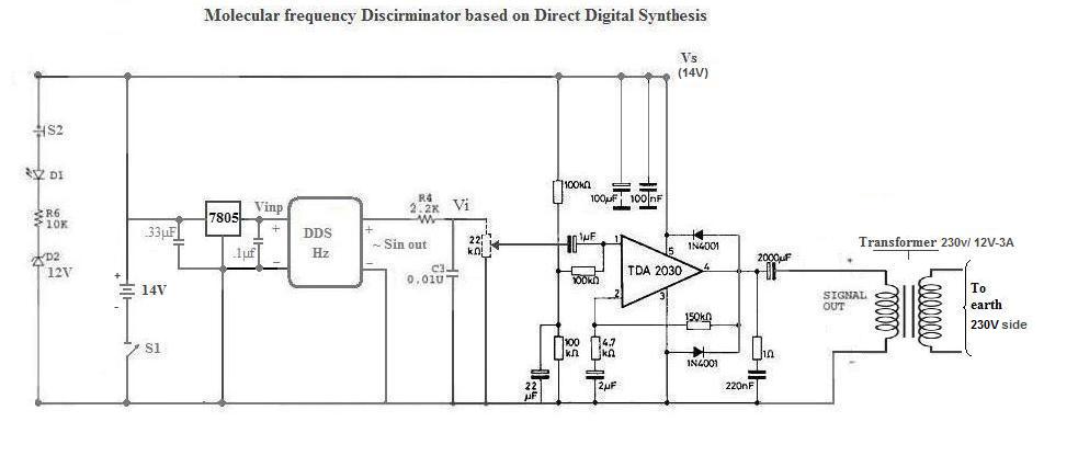

08-21-2012, 05:33 AM
No ned for ferrite transformer.
A simple transformer with iron core is OK.
A 230v/ 12V-3A is ok.

08-21-2012, 01:13 PM
Here the final schematic, many thanks dear ***Geo***
The 220v pole will be connected to bras earth, Geo? if we accept the input/output yield.

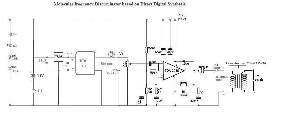

08-21-2012, 03:20 PM
Originally posted by
Freelander
You don't need C4.....

08-21-2012, 03:23 PM
Freelander
You must change the tranformer....
The 12V side must connected to TDA2030 and the 230V side to earth...

08-21-2012, 06:23 PM
Yes friend, this is the input/output transformer yield, only I did not prefer to write 12v/220v to not mix with a converter.
