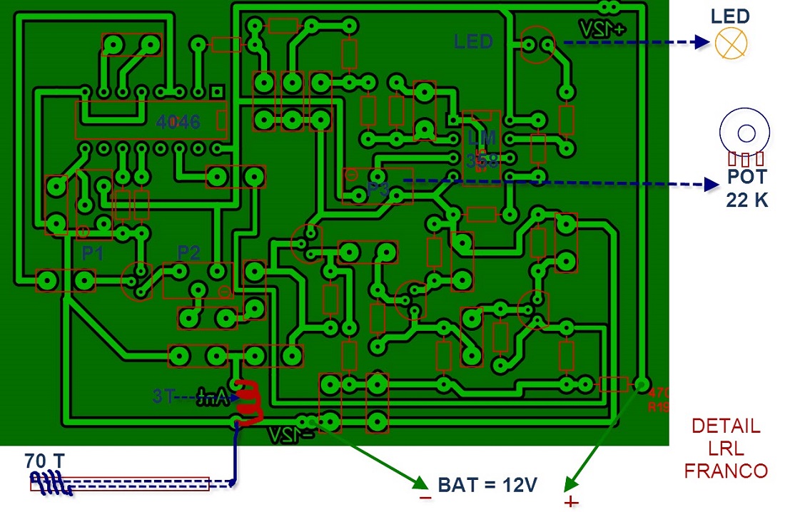

      GREAT MASTERS.
      - Lrlfranco locator box on the front panel R / S key to how this switch works there? Show this switch connectivity by drawing on the scheme.
      - In the same box with pvc pipe wrapped round copper wire diameter of 70 what will happen?
      Thank yo
      • Originally posted by iron1944 View Post
        Mr. Nicolas.
        GREAT MASTERS.
        Thank yo
        For detail look this picture
        For components PCB ask that from Geo
        Because my PCB is not the same of Geo
        Good luck my friend
        God bless all - Nicolas

          • Hi iron1944
            If You refers to my Lrl (the photo that I posted) in the main box there are power stage and display stage with LM3914 that drives 10 leds. In the front panel there are 3 switchs, one is power on/off, another for dot/strip led display, I mean only one led at a time or all the leds and the last switch is for inverting DC signal from the sensor stage (this is currently not necessary).The 2 terminals of the coil antenna are linked togheter and they go to L1.
            Best Regards

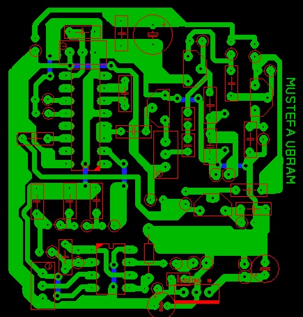

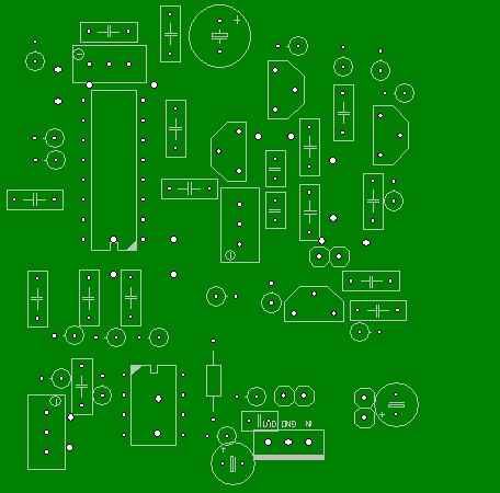

            • NEW VERSION PCB OF LRL FRANCO 6CM*5CM
              • Originally posted by mustefa ubram View Post
                Hi Mustefa Good work my friend
                • MR. MUSTAFA UBRAM
                  Thanks for PCBs
                  PCB BOARD write on the part numbers and part names.?
                  Thank you.

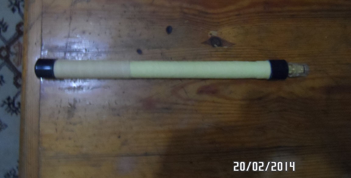

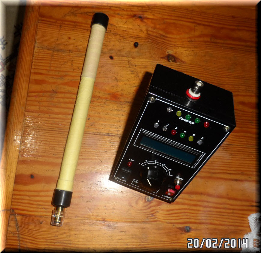

                      I put here the antenas Coil with Ferrite for LRL Franco and other LRL's it's more better than telescopic antennas.
                      Good luck to all
                      • My Degital LRL A24 with Antenas LRL Franco is so better and thus very sensitive than telescopic antennas
                        Thank you my dear Franco for this coil.

                            • Originally posted by Nicolas View Post
                              Hi Nicolas,
                              You say it is working much better, but doing what ?
                              It would be great to see results of your experiments.
                              Thanks!
