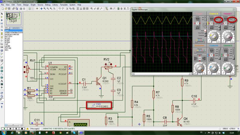

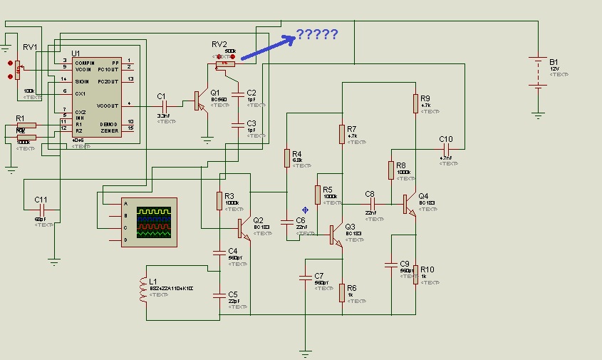

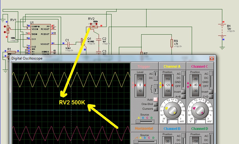

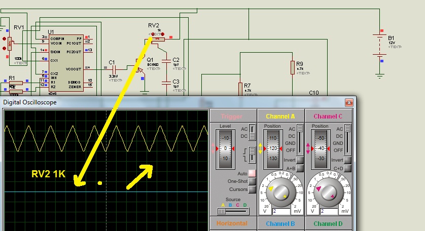

                        i found a problem in schematic and circuit
                        I have no signal in the capacitor 8 and 9 When the p2 is 1k.
                        But when p2 is hi Resistance 500k there is a signal The domain pin4 from ic1.
                        In your opinion, where is the problem?Which is correct?
                        franco
                        How much should a domain p-p in c9 and r11?
                        i put in attech protus file .please see and help me
                        best wish

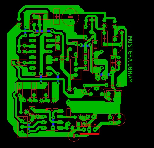

                        • new pcb lay of franco lrl gift for all
                          best wish

                            • Hi mustefa ubram
                              You have made my circuit? Or use only a simulator? P2 must be 1K, at TR1 collector it must be an impulsive signal not a squared signal. For the first time I'd suggest using an stylus antenna then go to the test field and vary P1, P2 and P3.
                              Best Regards
                              • Hi Mustafa
                                I think you need to change Q1 with bc183 in your proteus
