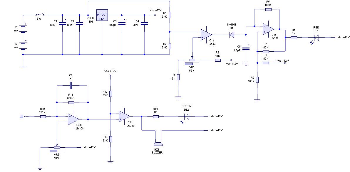

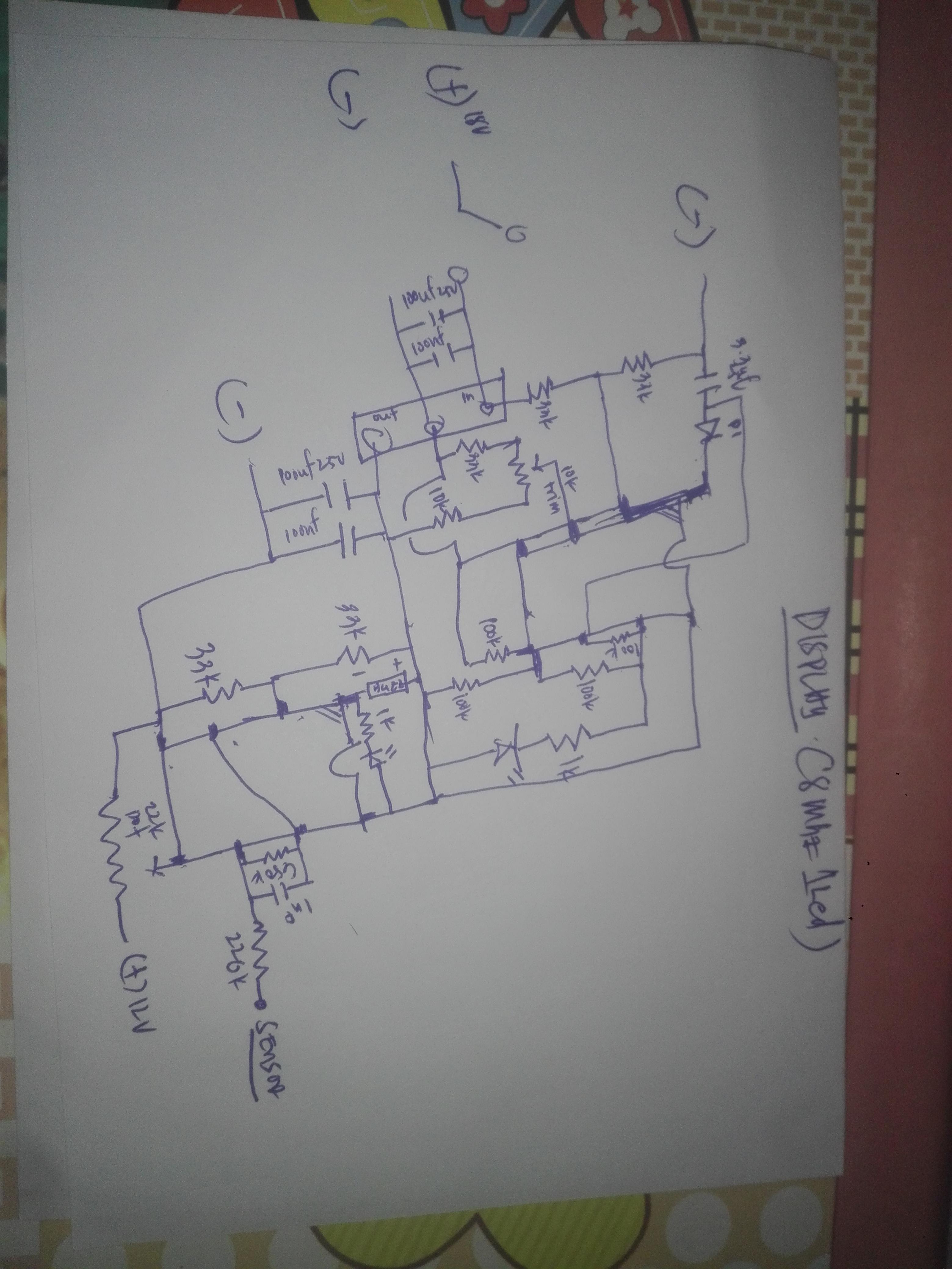

                • Hi to all..To master Franci and friend Jeg..

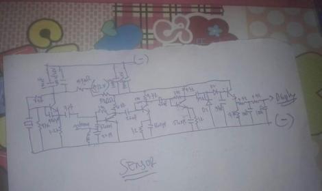

                  My first attempt was not successfull so I decided to remake it based on the circuit I attached here.. can anyone review the circuit I made if there was mistakes on it..I made the power stage separated to sensor as master Franco stated..I don not have tupe C transistor so I used bc548b..
                  These were my observations:
                  1.1.853 volts without quartz on output..When I touched the antenna it increases to 3.911volts.
                  2.5.678volts with quartz on output and decreases when touched..
                  3.two leds were on,The first was steady and the second led qas blinking...Is this normal Franco?
                  4.The buzzer was annoying,it continuously beeping so loud and no way to lower it..
                  5.the voltage output was increasing when I touched the potentiometer knob..
                  What do you think Jeg?
                  ps.I used 4mhz quartz on 8mhz display one led..

                  • If you read carefully the advice I gave for calibration, you see that without quartz the sensor stage DC output must be 0 V, otherwise self oscillation is present, and it is a condition to be avoided. The good news is that if there is self oscillation it means that the transistors have sufficient gain. Decrease C13 / C14, 330 pF or less, if not enough, increase R10 / R12, 1.2 K or 1.5 K.

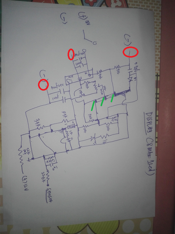

                      • Hey Jh
                        Also check in your diagram what i have in a red cycle. Are those points connected between each other as it should?
                        Check the green lines. It looks like your ground (-) connects to pins 2,3,4 while it needs to be attached only to 4.
                        I don't see something else. The rest of the circuit looks good.
                        After checking that you should follow what Franco wrote you above until you see zero volts at the output of sensor without crystal.
                        • In the power stage the LED flashes when the supply voltage drops below 16V, and this is adjusted by means of the potentiometer P1. You can use a stabilized power supply instead of batteries and set it to 16V, then adjust P1 until the led starts flashing.
