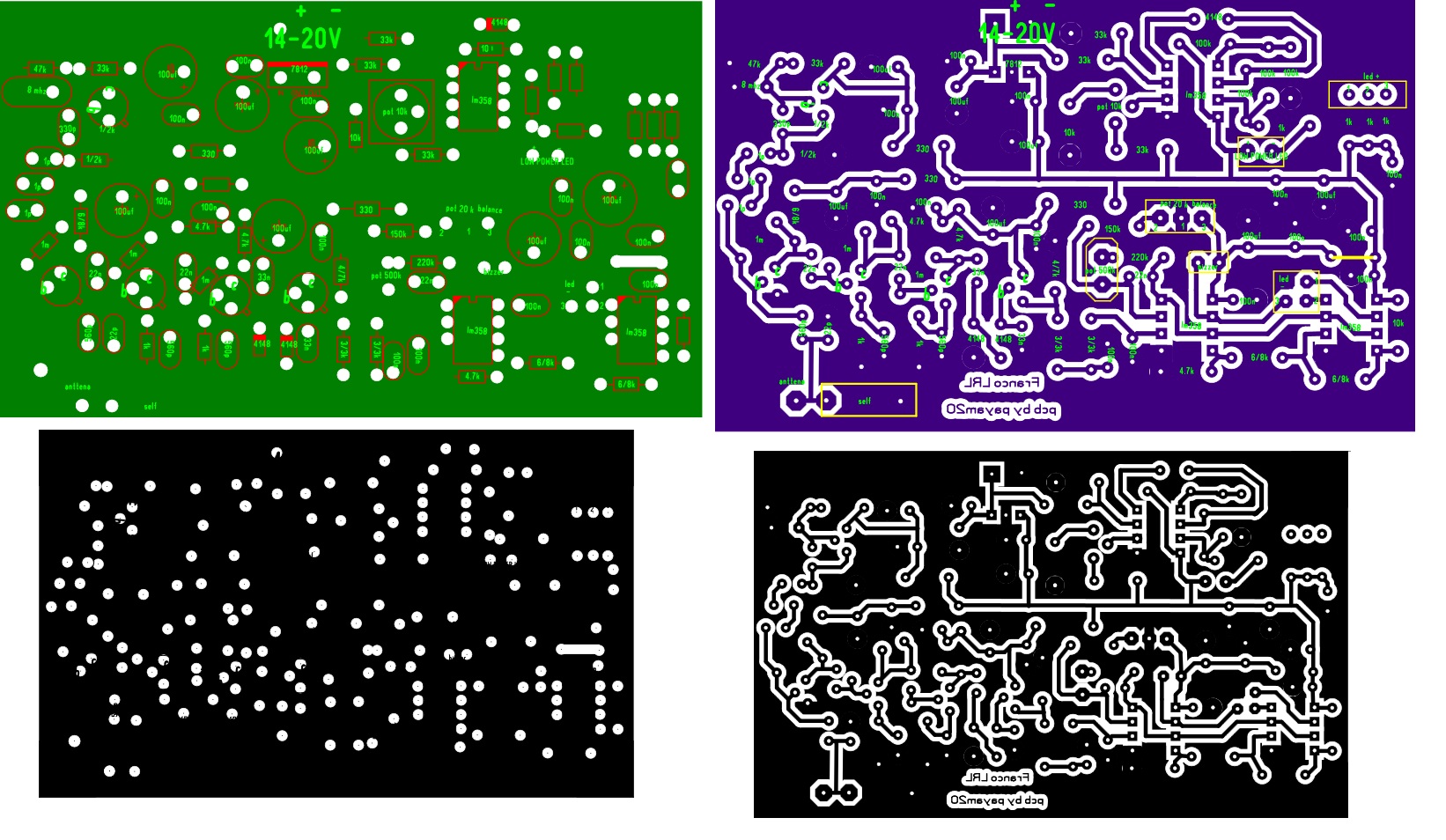

    my friend improve these items
    1-out put of reg7812 connected the ground !!!!
    2-connecte r=330r series with r=6.8k out put of collector tr2
    3-improve out put collector tr5
    • Originally posted by zakari View Post
      hi payam20
      thank you
      i will correct it
      but i didnt understand what you mean by: improve out put collector tr5
      and for number 2 . it make no differences as i have tested too . but i will do it as it is
      • Originally posted by liudengyuand View Post
        payam20,Hello, your PCB is positive and negative are copper? Or only the reverse side of copper? Please answer, thank you
        one side as franco said completely ground .and other side have ground zone too .

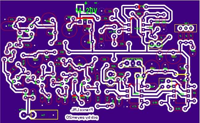

        • hi payam20
          how are you?
          if your pcb is according franco' schematic you have to put all components in schematic
          if you have changed schematic or pcb you must declare here
            hi payam20
            how are you?
            yes you are right . i put it right now as schematic.
            check it again plz maybe i have forgotten s.th
            • problme solved
              here you are
              • Originally posted by pigeon View Post
                hi
                thank you very much.nice job
                your wellcome
