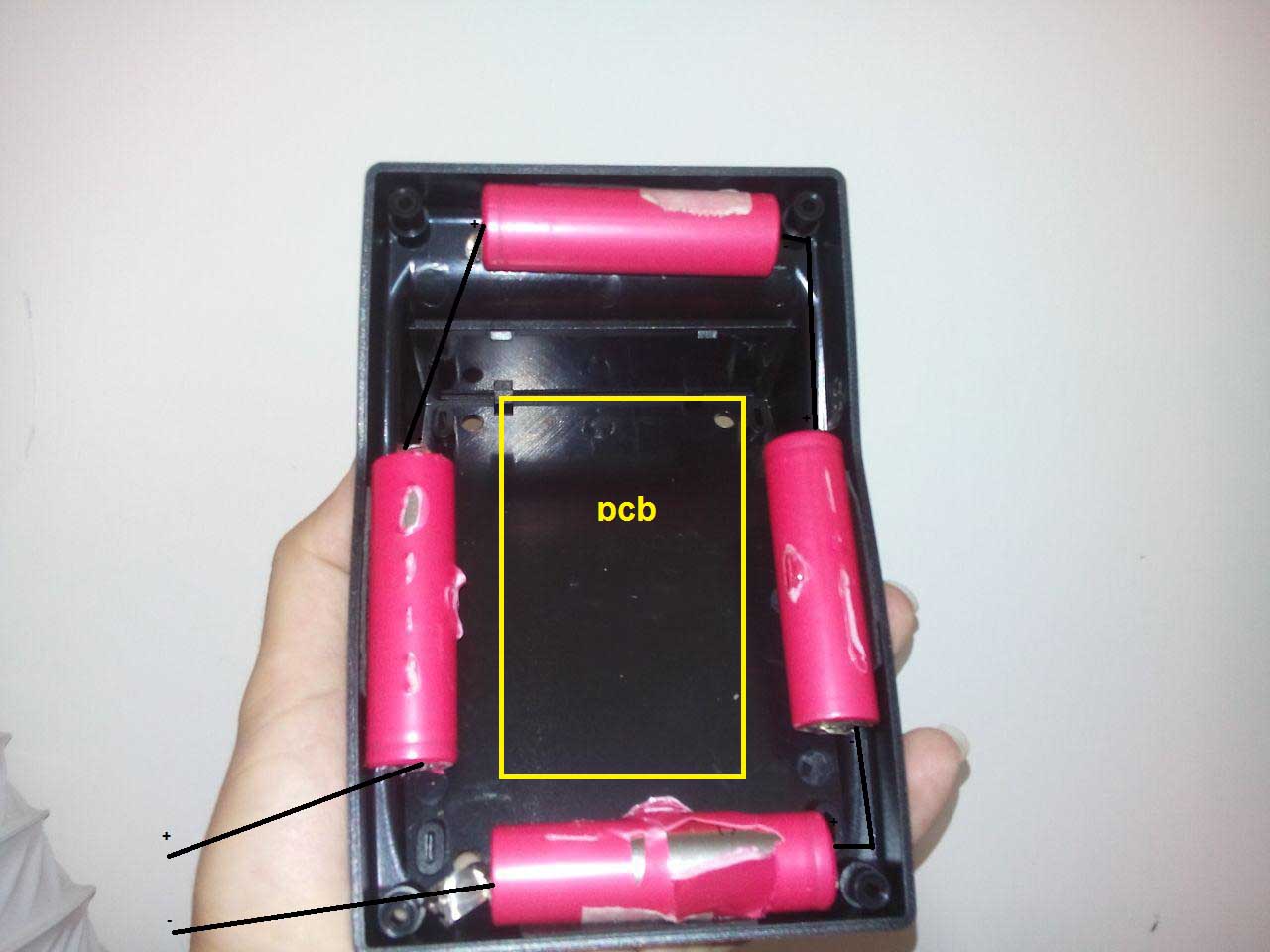

    Does putting batteries in this way creates pores in the boxes in the works?
    In general, the power supply does not need a separate box or differences?

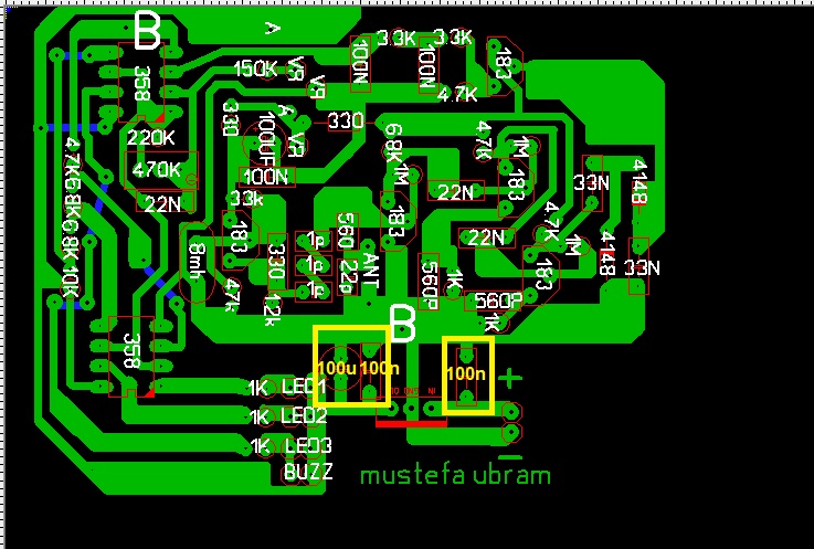

        • Hi dear Mustefa ;
          I've seen your Cristal 8 MHz PCB and faced to some questions. What are the components which I mentioned by the red lines in the below picture?.. one of them is L7812 regulator, but I dont know the capacitance of the rest of components.
          Thanks for your contribution my friend.

            hi freind
            I hope you have understood correctly mean.I have specified the amount of three capacitors
            best wish

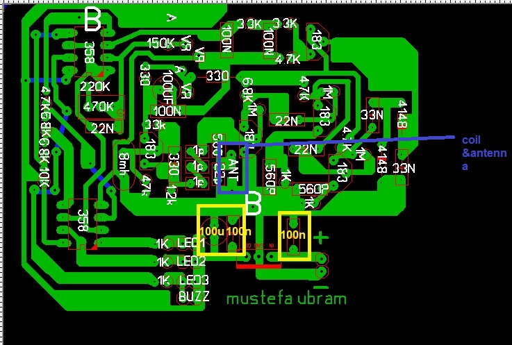

              • Dear Mustefa, I think you forgot to draw the place of 3 turns filter on the board. Please locate the place of the filter if it is possible.
                I Will Win, Not Immediately, But Definitely.
                    Dear friend . There is LC circuit board.I have identified.Be careful

                              hi mustafa
                              is what you can give me a picture to facilitate
                              fixing the choke coil and the antenna
                              thank you very much
