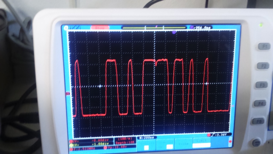

not yet George, but I think this antenna (80 turns) is more sensitive than the 35 turns antenna.Originally posted by Geo View PostBill, did you check it??
The reference for sensitivity, is the whip (stylus) antenna , but this does not mean that the "stylus" is always the choice.
Besides sensitivity, there are some other properties ,(varying among antenna types), which are sometimes more favorable.
Look the waveorm No3. I don't understand why is so....
This is one of the reasons that i prefer rhe Xtal version.
When will finish with field tests will open a new thread with xtal version because it works fine and the waveforms are perfect (except the display stages).
