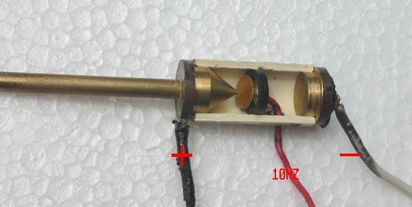

    in Original sensor have 24K gold on Sensor with connection of + and - ,
    so like Four and Five connection .
    You may be say for this ?
    Yes, you're right, I found a photo, and there five wires come out. There are 3 more volts on the sensor.
      I try 14 turns in 4 mm diameter, here it work better more turns than the 4 turns in schematic
      Very thanks Morgan , 14 turns , Coil Diameter is 4 mm ''O'',
      What is diameter of Wire , may be is from 0,50 mm wire ?

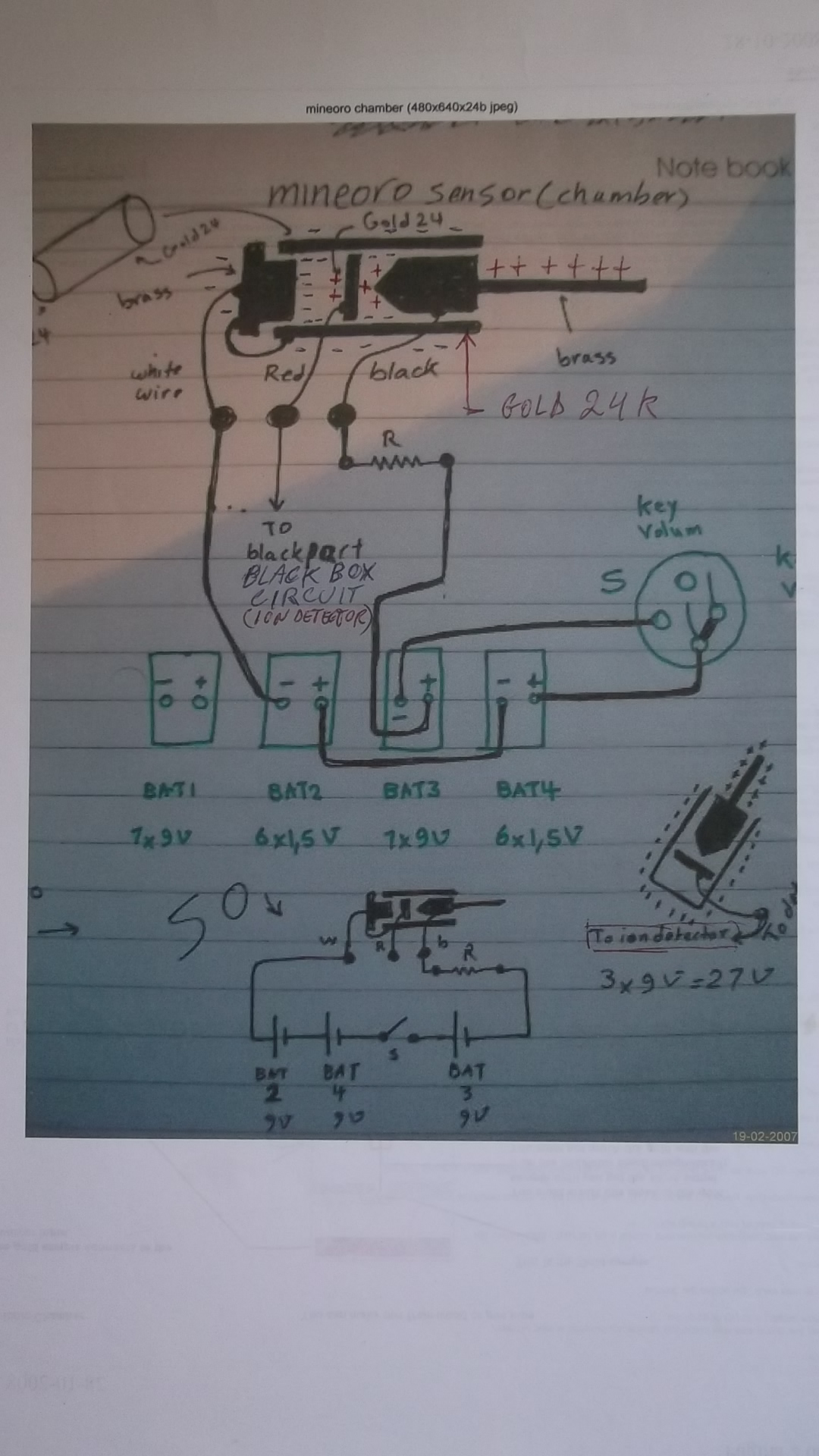

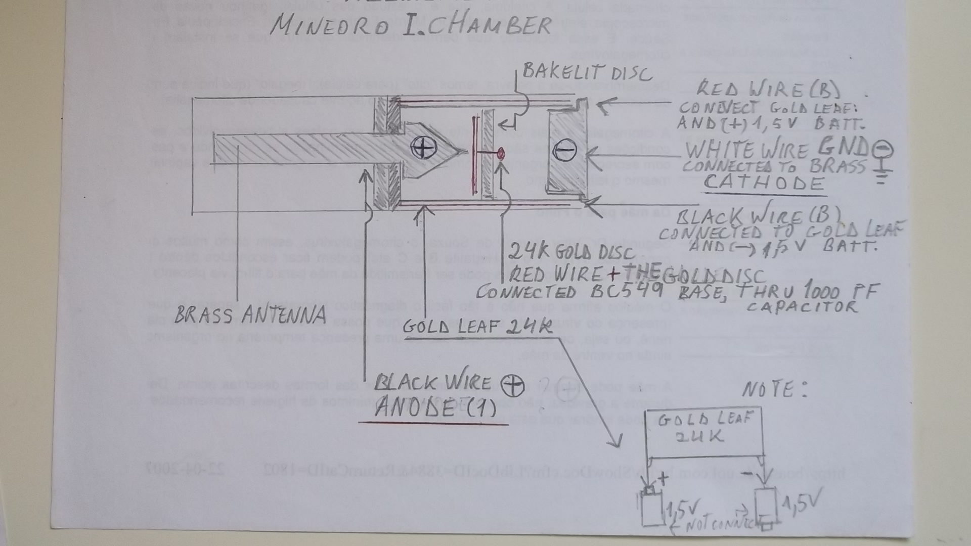

        I have two type Photos from Mineoro sensor which is best , and How is correct connection
        of '' +'' ''-'' and to Leaf .
        Org. Sensor and Greek Sensor ;
        correct connection

                  • mineoro GOLD CHAMBER
                    here some mineoro gold chamber for study:
                    the distance for the gold pin and the plate is exactly the moment the conductivity stop,maybe 0,05mm or less than that
                    • I mean the brass antenna pin as 0,05mm distance to the 24 Karat gold disc , thats to produce the GOLD resonace efect
                        the mineoros use this gold chambers and they will work only if the circuits are upgrade,Esteban and Geo made this modifications
                        Also in to me with few modification for many Km
