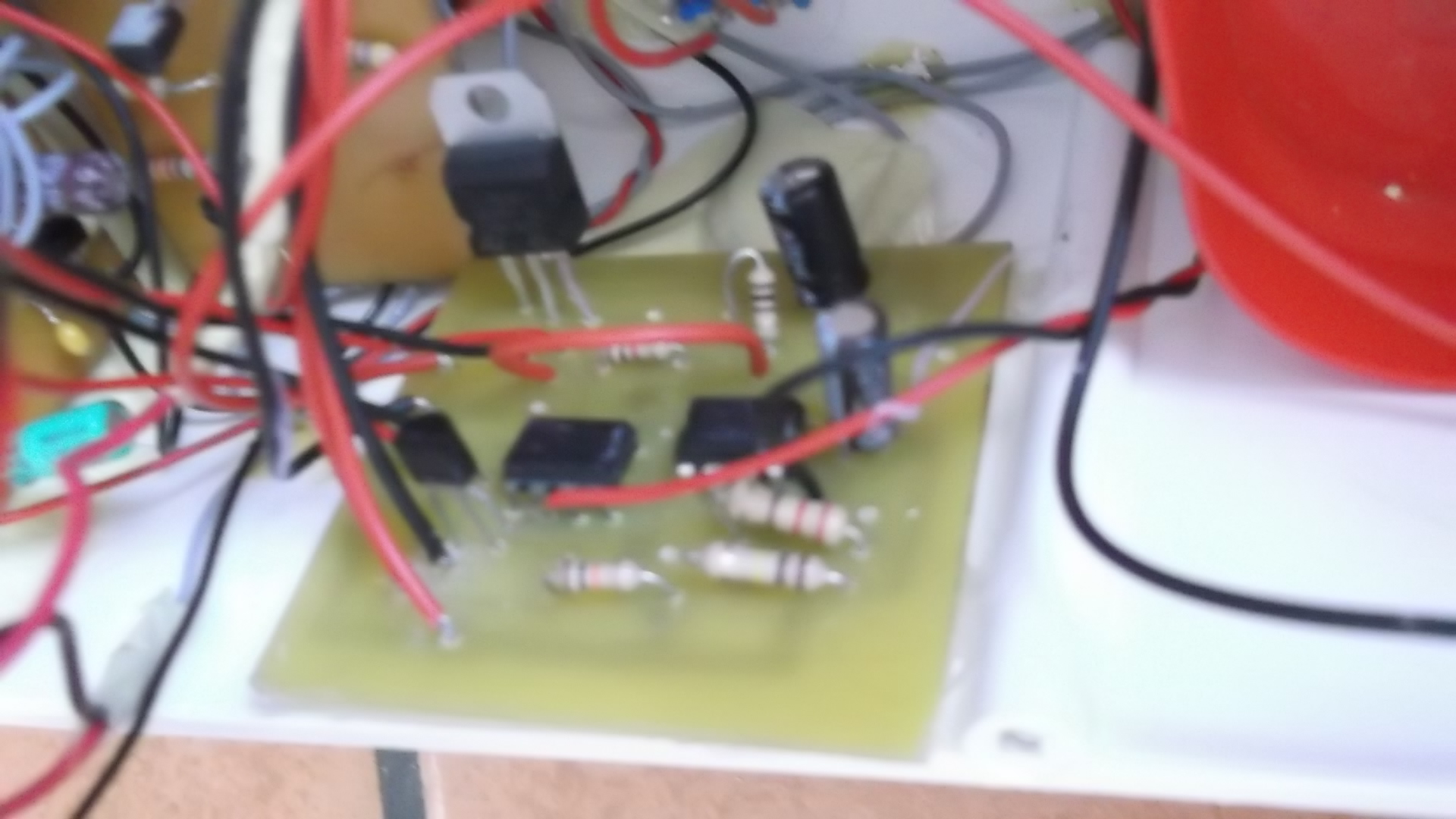

        I can send a KIT for you to instal in PDK-2,very easy,no need electronics experience, it upgrade very well for gold targets in remote areas where Phenomenon is more dificult,see the video and read how system work

                  as you like, I dont know behavior circuit have on this PDK CLONE, if you interested to try, I sent you but need to see where to put circuit, here photos of the KIT inside PDK-2,to have one ideia how it is
                      hi morgan
                      i think one of the ic is 555
                      and other is 358 or tl082
                      best regard
                      zakari
