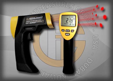

    Hey, guess what? I just found that Knouzm has now a representative in Brazil.
    I called and convinced him to go out to test the baby bellow which he sells.
    http://knouzm.net/en/dis-300.html
    I don't think I will have time to travel to another state just to do this , so I will contact one of my team members who live closer to know if he can do it.
    I asked the representative to receive the manual in my email. Price is 'bitter' like any Knouzm.
    Very interesting.
    I just read the manual and it works by temperature comparisons. That is, this device is a digital infrared thermometer which measure soil/ground temperatures related to royal, noble metals which absorb heat and get warmer than the surrounding soil environment.
    It pocesses several laser beam patterns. What it does is that when pointed to a target, the infra red thermometer lens focus the energy colected onto a sensor. Then, this is translated into a voltage signal which is directly proportional to the received energy amount. This is all done by an internal microprocessor which displays values which guide the user to know the target's location and the depth it might be.
    For caves, the opposite is performed, which gives a lower temperature then the average surrounding.
    You turn the detector on , measure the temp in 4 directions, (N, S, E, W) and then with this computed value you start the search.
    Although I find very plausible its working method, I have doubts it will work all the time, regarding different soil conditions, but I will try to see if my team member spends an afternoon testing the unit.
    If if proves ok, it will be a good mate for my Mineoro, specially because this laser device is supposed to work better at night.

                The "Laser Gun (DIS 300) device detecting for Gold, Treasures and Caves" is actually an infrared thermometer that appears to be an instrument manufactured by Oakton Instruments in Illinois, or a very close copy of one.
                In fact the manual confirms that but tells that they performed modifications on the unit for treasure hunting use which also includes adding two more sensors.

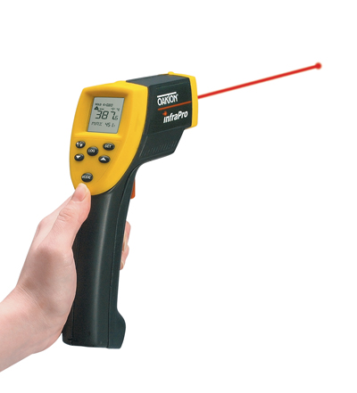

                        OK. After taking a closer look on the links JPlayer provided and re-reading the Knouzm laserscan manual I came with the impression that they indeed modified the laserscans to find treasure.
                        1 - They redesigned the LCD screen which features 2 modes. RANGE and GOLD. First the user turn the device on and set in RANGE. This allows collecting the temperature in four directions in the ground. Then he changes to GOLD and start searching. When there's a 10 degree + change, the target is located which I suspect as I said earlier, they collected the data for gold temp location.
                        2 - And this second evidence may corroborate my thought of the unit being modified. This is in the manual:
                        NOTICE:
                        I- This device has been manufactured for many purposes. Regarding the
                        treasure haunter, two sensors were added to the device to work more
                        professionally in the difficulty soil and earth conditions.
                        So as can be seen, despite the fact that this is in fact an OAKTON unit, even if it's already discontinued, it probably was modified.
                        JPlayer, my invitation for you to test a regular OAKTON and compare results with my possible test is still up.
                        I inspected closely all the pictures of the oakton models and cocluded that the knouzm unit is not any of them altough the colors and shapes look similar. For instance, the knouzm unit has only 3 pushbuttons plus mode , the oakton 9 beam has 5 pushbuttons plus mode. The LDC in the knouzm is quite bigger than the oakton's.
