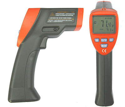

    • #17
      The DIS-300 is actually a Mastech MS6530. It's highly, highly unlikely that the DIS-300 has any modifications, certainly not with the LCD. It's also impossible that their claims are true... buried gold absolutely cannot be distinguished from anything else based on temperature.
      The evidence overwhelmingly suggests that this company sells treasure hunting scams. The fact that they also sell dowsing rod devices pretty much cements that conclusion.

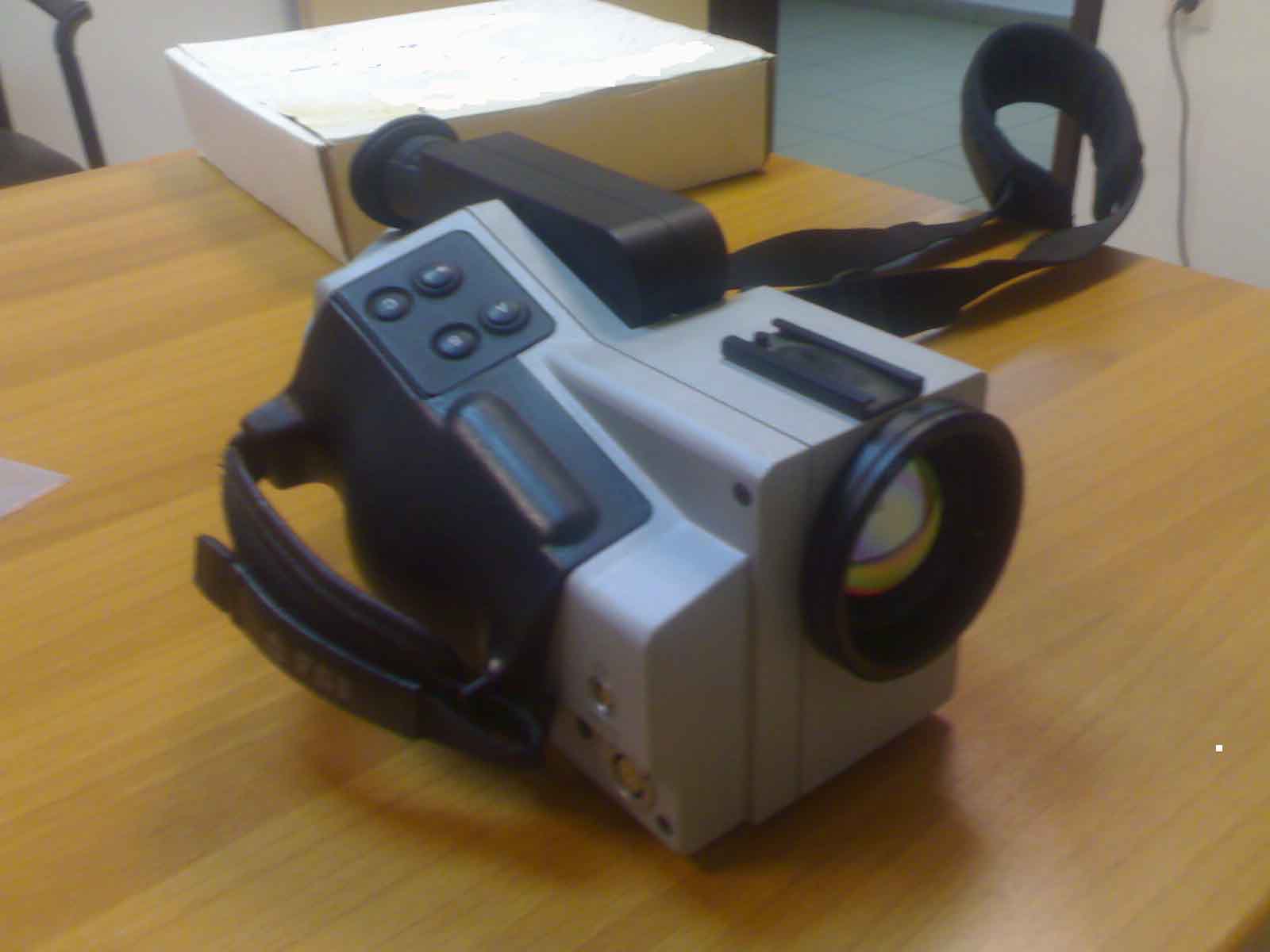

            I agree. My very expensive thermocamera isn't able to detect metals in the ground. Only if a big metalic object is in the ground 10..20cm then i can detect it only at the hours of day.

                Mastech device in the US?? Try China
                I must congratulate Carl again for his excellent work in finding the exact manufacturer of the knouzm thermometer treasure finder. It's no wonder I couldn't find it because I was looking for the USA manufacturers per the Knouzm web page that says it is made in the USA.
                We in the USA cannot easily test the Mastech MS6530 because it is not made or sold in the USA. This thermometer is made in China. The only place it is obtained in the USA is through the Amazon.com seller who imports it from Hong Kong.
                Mastech no longer lists the MS6530 in their catalog, as it has been replaced by the newer models. As near as I can tell, the remaining surplus stock of the obsolete Mastech MS6530 thermometers can be imported direct from the Hong Kong factory contact for low factory surplus prices if you need a lot of them. Scroll to the bottom of this page and contact Connie Keung for volume discounts:
                The Knouzm company lied to us when they said it is made in the USA on their web page (DIS 300 feature #15): http://knouzm.net/en/dis-300.html
                Knouzm lied about the place this thermometer was made just like they lied about the "13 Laser Waves considered as Ground Probes to measure", and just like they lied in their manual about adding two extra sensors for the treasure hunter. This is nothing but an obsolete Mastech Infrared thermometer that you can buy for about $100 or less from a Hong Kong importer. It cannot "discover from 20 Degree C to 527 Degree C for far distances and huge depths" as the web page states. It can only measure surface temperature. The Knouzm "Laser Gun (DIS 300)" cannot find treasure any better than an obsolete Mastech MA5630. Why would anyone pay $6000 for this cheap thermometer? Because the Knouzm company lied and made them believe it was modified so it can find treasure? Hahahahaha what kind of retarded idiot would believe that crap?

                  OK, I found a MASTECH 6530 being sold here in an out of state store here in Brazil. Price is not as low as in the US.
                  Only way to know if they are similar is comparing both.
                  I will try to test or have someone test the knouzm device here.
                  Alhtough Knouzm is notorious for his outrageous prices and doubtful products, I will give them the benefit of doubt for now.

                    I have just purchased a MS6530 off eBay, for $59. Compare that to $2200 for the DIS-300.
