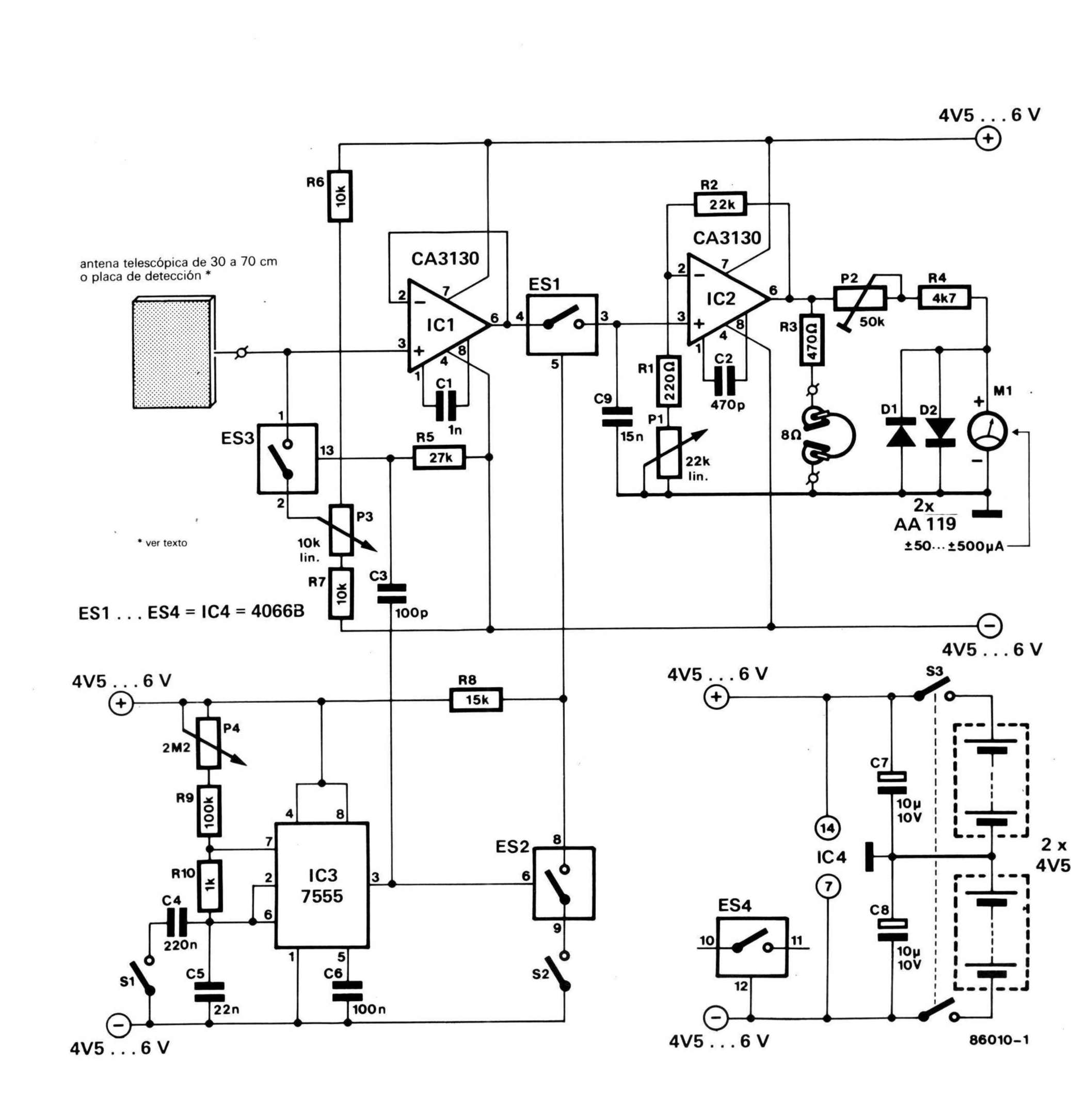

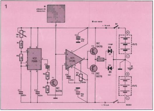

        • schematics from Esteban (and others)
          maybe someone forget older threads... posts by Esteban and others...
          old stuff... serves nothing... can't find any gold but powerlines...
          Some people here built them and get no results ... but just detecting noise.
          Main problem was always AC fields by power lines... then all the rest of noise out there. Seems nobody found even known long time buried targets with them.
          But if you don't belive my words...
          here are some of the old schematics by Esteban, Carlos etc etc etc
          are really easy to do yourself... do it... see with your eyes !
          enjoy
          • Originally posted by Max
            Ok, now you have your schematic of LRL. Can we finally see the end of your clown postings begging for schematics?
            • Hi JP,
              no !
              I have them already... old stuff. Mounted one and saw same things as Ivconic, Michael etc.
              No, no... these are not Esteban's designs
              Carlos and Esteban posted them... but are from magazines... to find water flows etc
              I asked him for one of his (original) designs and one that he claims working... detecting e.g. a coin on surface soil from 2 meters away.
              Do you remember ?

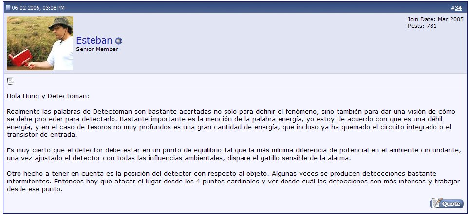

              • spanish lesson
                now ... if you understand even a bit of spanish... look at his assertion about the "equilibrium" point you need to get a useful signal: the nulling of device is critical to avoid getting false signal from "environment".
                Now think you are immersed in noise... RF-stations, power-lines... even cars... or opossums... do you think you'll never find the treasure that way ?
                BS.
                But I'm ready to change idea now... if someone gives me facts!

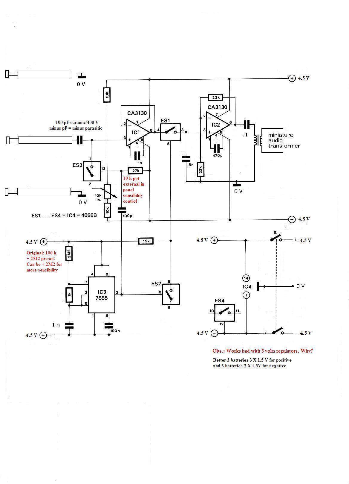

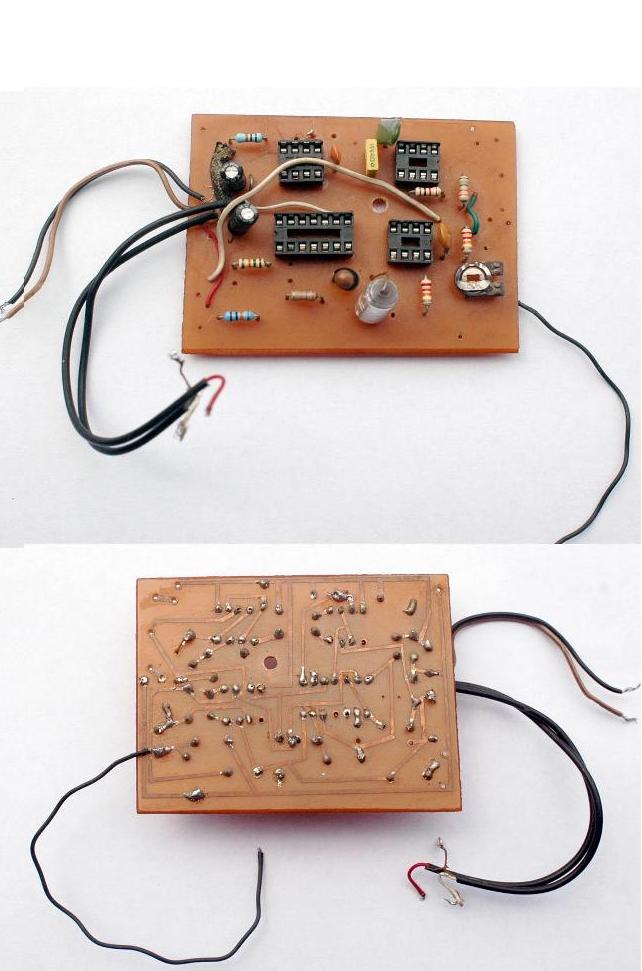

                              ...about circuit... well they work for power lines very well...
                              so you can use e.g. to find wires in walls and similar stuff, I've made something similar in the past and are useful if you have to find where they are...without dismantle the house.
                              Here is the prototype by Esteban of the first one if I remember well...
                              even if sloppy I think it worked, but same of what I've made !
                              I hope he made better PCB now... better than mine I mean!
                              • Carlos and Esteban posted them... but are from magazines... to find water flows etc
                                Of course, and the Ivconic's implementation was based in it. If you read all the text, in the final part, is possible to find another kind of anomalies. The text assures that water flows into the earth and creates ionic interchanges.
                                Yes, also I said that these devices (like Zahori) is for use in inland sites, regarding interferences. No mistery here. I don't imagine excavating in the street with intense vehicular traffic or similar places.
