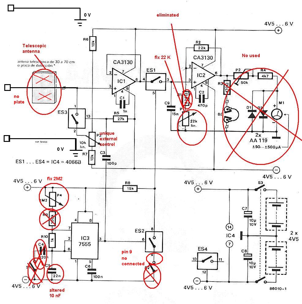

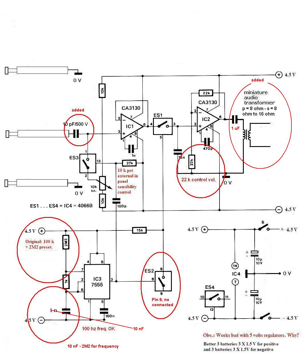

    I check my old PCB and found an only error regarding 1 nF cap, really is 10 nF. In other words, frequency is 100 Hz or near 100 Hz in pin 3 of the 7555 (or NE555).
    Respect Ivconic's implementation, no necessary all the switches and caps. Only a 10 K pot. and switches for batteries. This pot. acts as sensibility control as a threshold adjustment. No need more.
    My alterations are:
    1. 3 telescopic antennas. Plates collects more interference and shows capacitance. Laterals antennas to 0 V. Laterals open 40-45 cm and central 60-65 cm.
    2. Variable 2M2 preset replaced for fix resistor of same value.
    3. Eliminated 100 K resistor in serie with 2M2 preset replaced, now fix.
    4. Eliminated both switches S1 and S2, wich select for search electricity in walls and water flows.
    5. The point 4 mean that only 10 nF is connected between pins 2-6 to negative.
    6. Pin 9 of the 4066 no connected.
    7. Eliminated visual section and replaced by trafo.
    8. 22 K variable resistor (volume) replaced for fix 22 K.

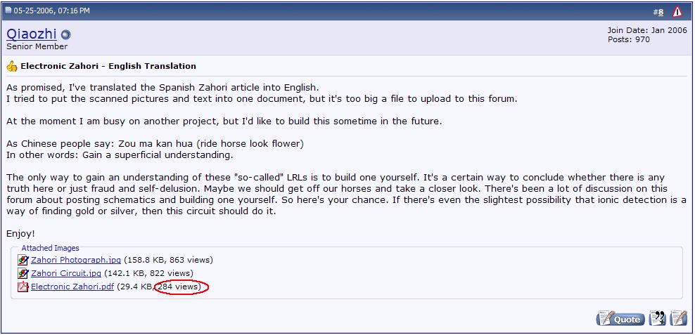

    About text, translation by Qiaozhi has few readers. Near 600 in difference who looks images. Here:
      Features:
        Hi Esteban,
        Yes, it is very strange. Why did so many people download the circuit, but not the description about how it works?

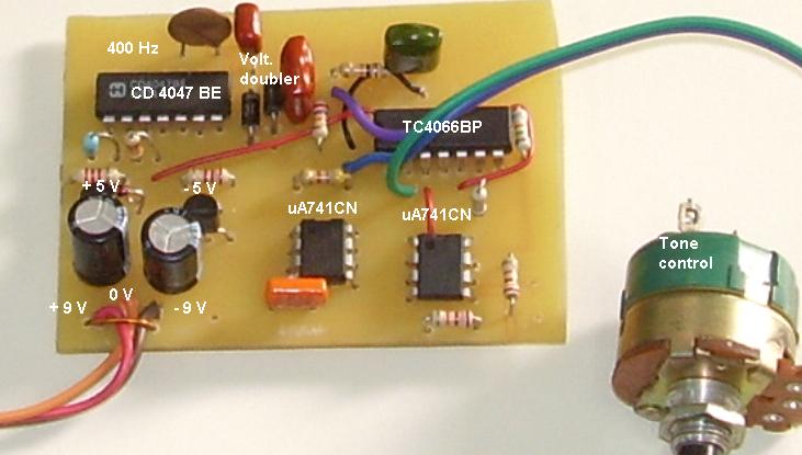

                      New Zahori. I build this with tone control as MD. Arrival signal mix with the audiofrequency and go!
                      No yet assembled it. 741 reveals also very sensitive in this new dispossition! 555 was replaced for 4047 BE, good IC. Also put a voltage doubler wich ups the 18 V to 35 V. Maybe can be useful for to polarize a kind of aluminium dish.
                      In via for to obtain more sensibility, I replace the 741 input for the faster LM318, but the noise is incredivel with this dispossition! I hear noise inter-stations type AM! So, return to the 741.
                      Pin 13 of 4047 BE shows frequency X 2 = 800 Hz. Really I obtain 411-412 Hz and in the pin 13, 822-824 Hz.

                          This is the final schematic of old Zahori with modifications. Here isn't audio stage.
