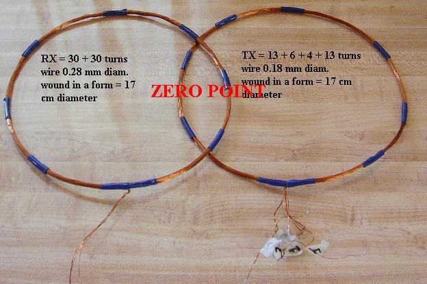

Occurs on the workbench. But if the capacitive effect acts in this way on the workbench, I select the part (down) with shows capacitance effect near the soil when I use as metal detector.Originally posted by Fred View PostHi Esteban
So what you are saying is that this effect is nothing more than Earth capacitance effect?
For example, I rebuild the coil type O-O. 17 cm diam. each. But transmitter is different turns: 13-6-4-13 turns for transmitter wire 0.18 mm.
Receiver: 30+30 turns 0.28 mm.
You note here reduction of capacitance effect with gross wire in rec.
But here, you don't use omega coil, just O-O.
This looks like the windings required for a GD-48, but what do you mean by "gross wire in rec"?Originally posted by Esteban View PostOccurs on the workbench. But if the capacitive effect acts in this way on the workbench, I select the part (down) with shows capacitance effect near the soil when I use as metal detector.
Please explain.
GD-48 uses thickness wire in tr. coil and thin wire in rec. coil. For example, a coil with 30 cm diam. in general uses wire 0.45 mm and rec. coil 0.22 mm. Here is contrary: the rec. coil uses thickness wire (0.28 mm) and the tr. coil is made with 0.18 mm wire.Originally posted by Qiaozhi View PostThis looks like the windings required for a GD-48, but what do you mean by "gross wire in rec"?
Please explain.
With this model capacitance effect is reduced.

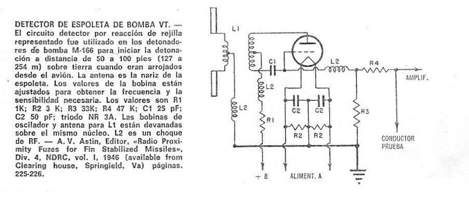

Why not... Some bombs explode above ground 6-7 feets, other 120 feets, based on capacitive effect, in water or ground. This reacts at 50-100 feets (27 m to 54 m). Antenna is the nose of the fuse of the aviation bomb. Was published in electronic circuits book by J. Markus. There are more circuits like this...Originally posted by Fred View PostEsteban, tell me if i am bothering you,

Thank you Esteban, that is interesting and i will try to find more about those systems.Originally posted by Esteban View PostWhy not... Some bombs explode above ground 6-7 feets, other 120 feets, based on capacitive effect, in water or ground. This reacts at 50-100 feets (27 m to 54 m). Antenna is the nose of the fuse of the aviation bomb. Was published in electronic circuits book by J. Markus. There are more circuits like this...
