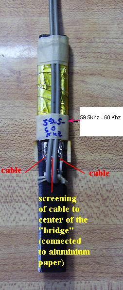

              I don't know about this list and I don't made based in it. In particular I made oscillator 50+50 turns wire 0.15 mm in form 10.5 cm wich has best peak with correct capacitor and resonates at 59.5 Khz. I found gold with it and even gold plated buttons war times, century XIX. This not mean that gold resonates at 59...60 Khz, yes the peak in transmittion occurs at 59.5 Khz with the values in wire and capacitor.
                Ok are you tellingus this is the pickup for gold at 59k.
                Can you give step by step on using this to pick up the gold signal.
                WE NEED 3 PEOPLE TO MAKE AND DETECT THIS SIGNAL.
                I WILL TEST THIS PICKUP,now we are getting somewhere with this.
                    With 0.15 wire you have a low Q!! Maybe this is the reason that you located gold at 59500. If you put 0.30 or 0.40 wire and tune it at 59000 maybe it is better.
                    If you will find time try it at the place where it is the buried gold ring from the "child"
                      This wire permits me use just low capacitor for small diameter. If I use .30 or .40, must made more big coil for to mantain low tune cap. Prefer small coil with 0.15 wire for small objects.
                      The child looses the ring playing. Today the child is not the child...
