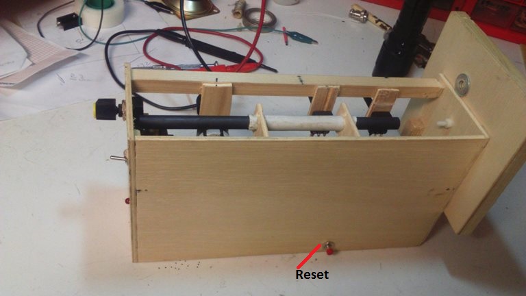

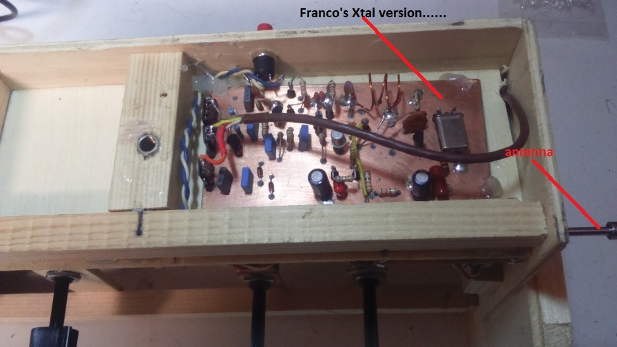

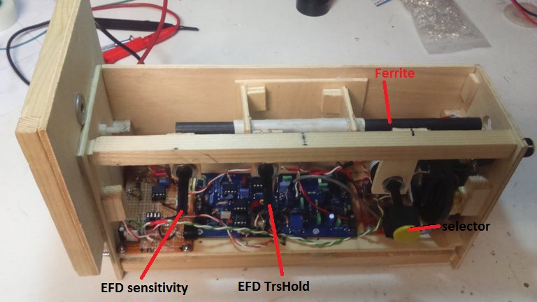

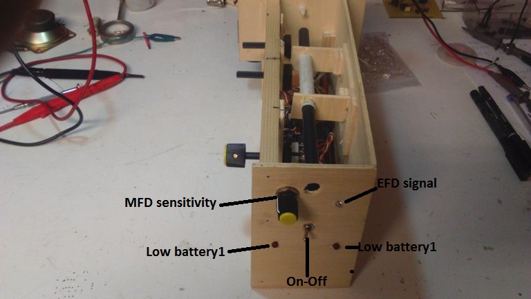

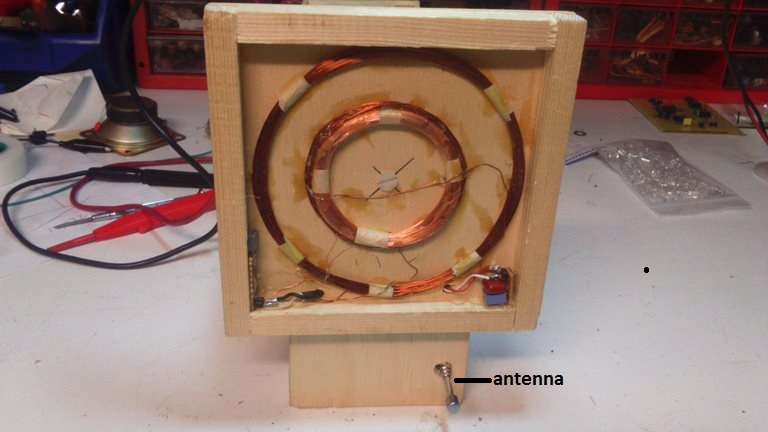

                  • New detector is ready. The only that i must do is to close the box, so i give some more photos.
                    • ...... other two....
                      • Hi Geo
                        What kind of Omega antenna is this ??
                        Does this new project is yours or modification of FrancoItaly schematics ??

                          Coil is not an Omega type but a Coplanar. It works as a magnetic field detector and the ferrite back of it "gives" more sensitivity. It can detect a buried coin (for long time) from 15m easy. With it i found a metalic box from 70m far.
                          I don't understand what you mean about ferrites. Ferrite at my lrl has a u=400 and dimentions 10x200mm.
                          The EFD is the Franco's detector, the xtal version. I did not check it again after the mods....
                          Will try to do it soon.
