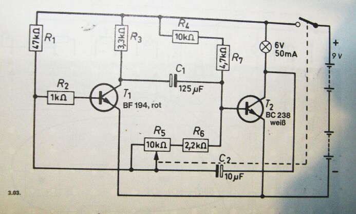

                    But the second one would be better: Converting the actual electrostatic power level into some blink rate and keep this in the middlefield. If some treasure is near, the blinking increases, if you walk away from it, it will decrease. This blinking would be work parallel to the analog audio output, so you also can hear special electrostatic signals like power lines, the zhzhzh of a plasma-ball or some kinds of trafos.
                    Is there some easy way converting raising voltage (those one before or after the transistor stage) into higher blink-rates? Perhaps simply by some small condenser, but this could disturb the audio-output.

                            @ Geo
                            Here is a simple but widely variable blinking circuit where the frequency is controlled by a 10-10k Ohm poty.
                            If you attach the (amplified FET etc.) LRLs output even parallel (instead of the var. resistor) to the blinking circuit you'll get the signal-power by blink-speed.
