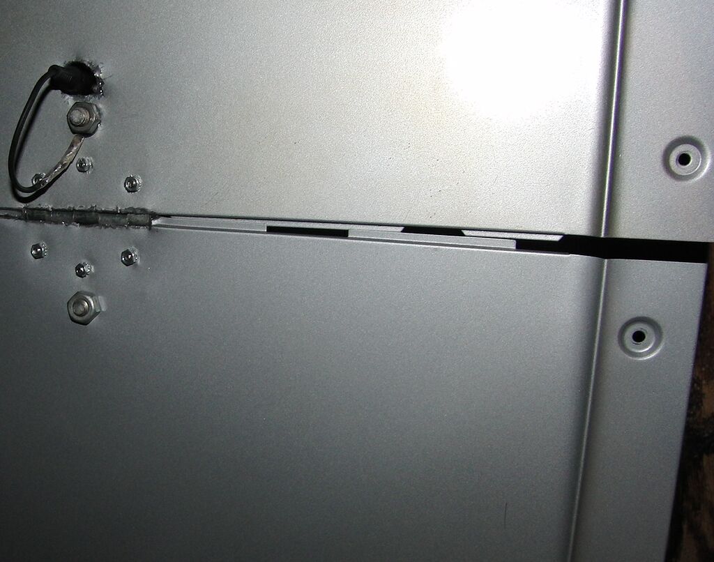

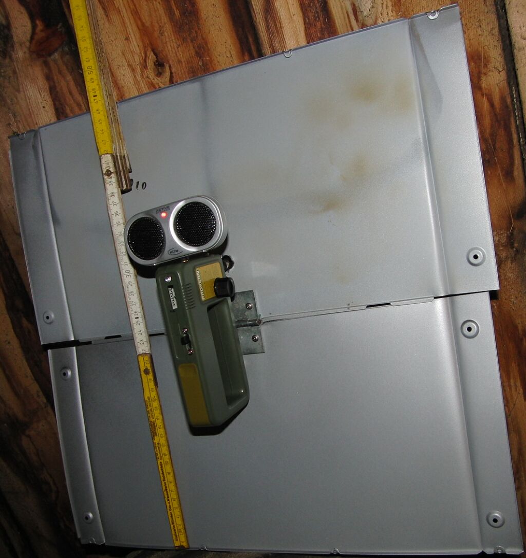

Instead just making comments like some others here now I build a nice large antenna, using the both top-covers of two old DVD-players.
The size is about 47x50cm and for transportation just 25x50cm. Weight incl. detector ca. 1kg.
It's crazy - it already recognises if I move my fingers while holding and beeing near some electricity-cable!
Those now get detected from 1,5m.
And if I'm leaving the detector there it recognises when I'm coming near from around 50cm distance.
I'm curious what outside tests will show.

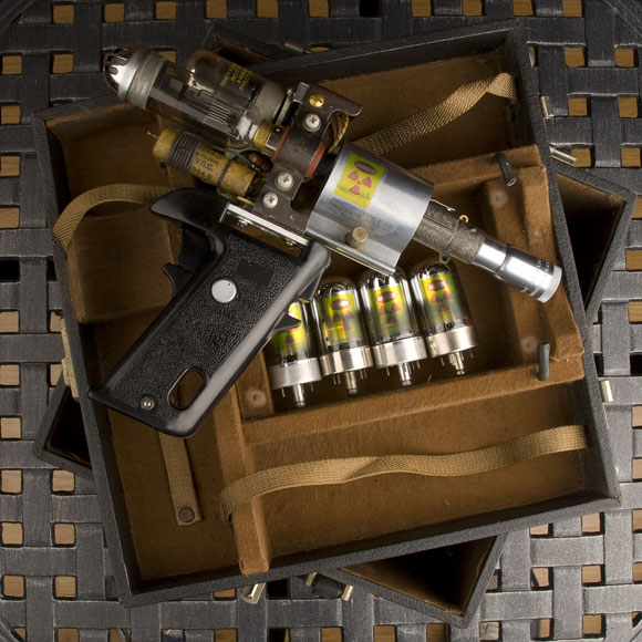

@ Qiaozhi
Very cool E-guitar design - has something from H.R.Giger (Alien movie design).
But for what is this hitec pistol?

Absolutly correct - the larger the electrostatic electrode surface the better - and i think I reached already the useful portable size.
The gain doesn't double in sqare-cm but is more like this (round plate, electricity cable):
no antenna (5cm wire) 20cm
10cm wire: 40cm
20cm diameter plate: 70cm
30cm diameter: 1m
50cm (my new antenna): 1m50
So with an 1m antenna you could get around 2m but for outside usage it starts to get problematically (especially if its windy) and really heavy. So the reasonable maximum size is reached.

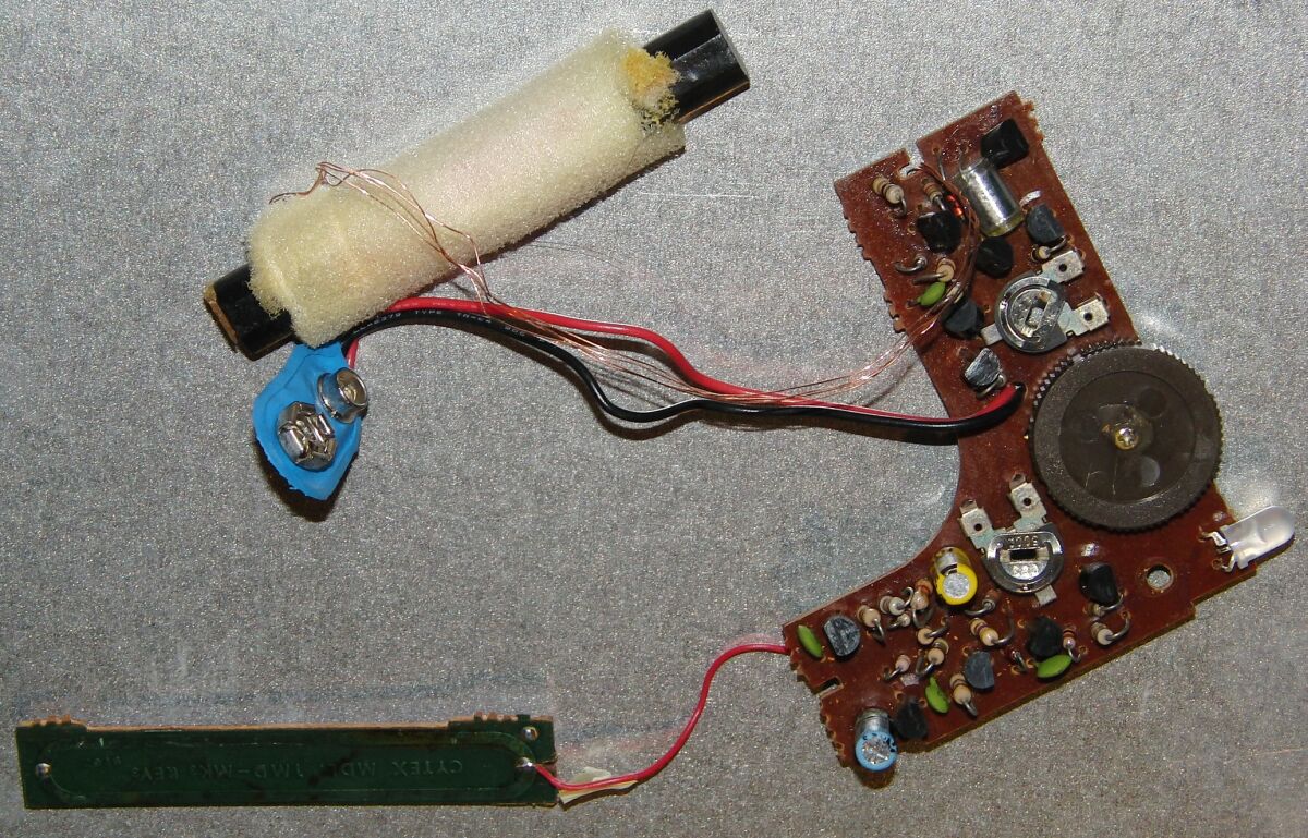

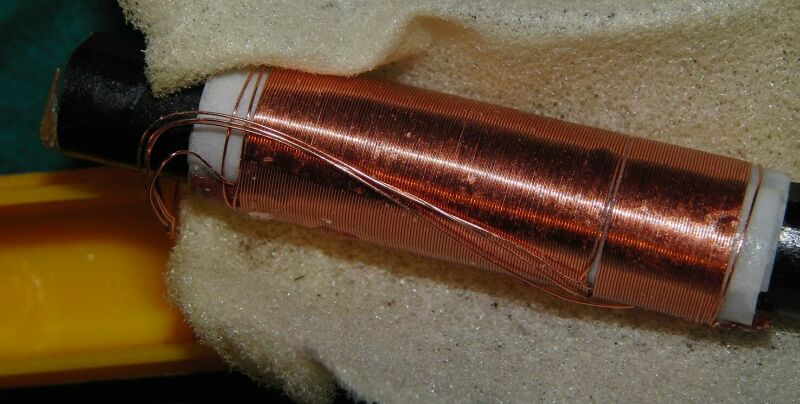

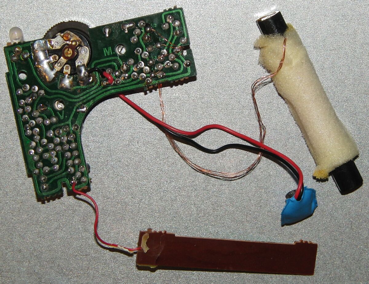

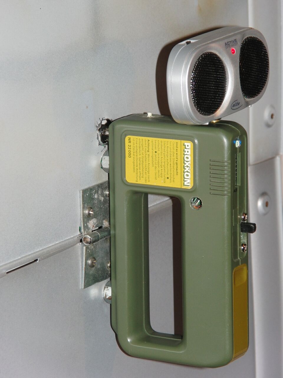

btw. I had already an electrostatic receiver!
It's a 2in1 wiresearcher from multiTEC (Made in China, ca. 10 years old) but it doesn't use FETs, just simple transistors (9014, C9014).
The windings are ca. 130 / 35.
The LED also is 2in1 with green and red light, depending if metal is near or with blinking if electricity flows in the cable.

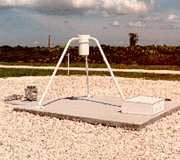

But now I found out what we really need is called: "field mill". It is the most sensitive electrostatic detector - down to 10v/meter while our detectors only have around 1kV.
Weather stations and airports use it to collect smallest changes in electrostatic field. But we need one that is not fixed to ground.

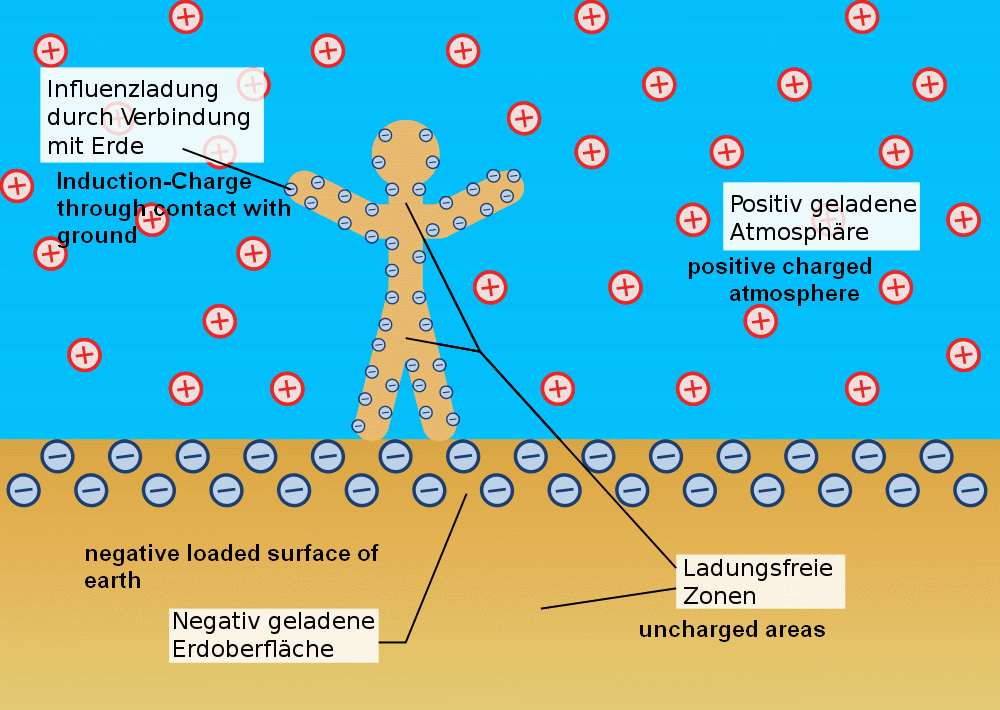

A person, standing on ground is negative loaded by influence (=electrostatic interaction).
And on cloudless sky there is 100 V/m to 300 V/m static charge. This can raise (at thunder and lightning) up to 25 - 35 kV/m. Ion concentration in air has also large differences.
