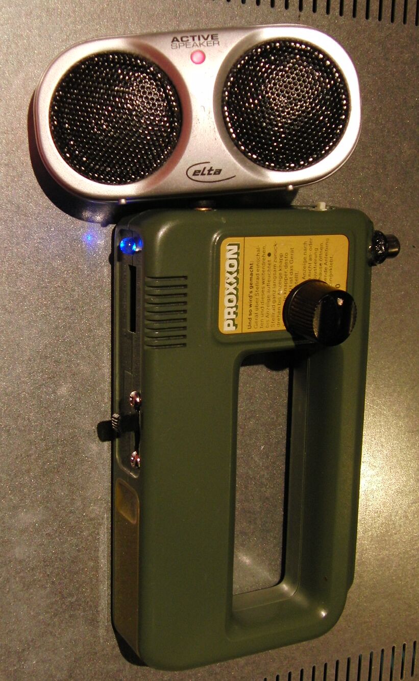

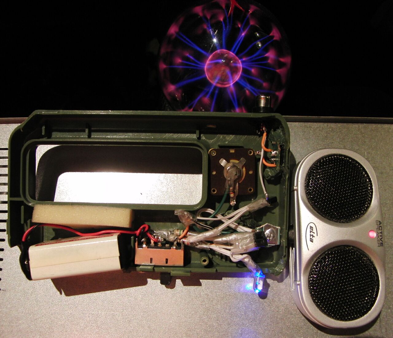

                          I've made it!
                          I can tell you what:
                          How to finally built this detector really was a hard nut to crack. But now I'm really happy.
                          I decided to use the case of a wiresearcher because it is light-weight, has already place for a 9v block plus electronic and a practical handle.
                          I don't care if the case is out of plastic because I recognised those small electrical charges from that vanish very fast.
                          Into the front side is melted a female chinch jack so I can check out all kind of different antennas. The 3,5mm stereo jack is on the top side for active speaker or even ear-phones.
                          Nearby is a small switch that is connected to a variable capacitor. If it's off, the JFETs antenna will got the full power, but sometimes the electrostatic field or signals are too strong so I can put it on and tune it to the best level. The knob of that capacitor is located on the side.
                          Soon I will update the schematics so you know where it's connected and I really recommend to add such a variable capacitor, too.
                          On the front side is the battery-case, the ultrabright LED and an on/off switch.
                          All in all is the size only 15 x 8 x 3cm and with active box 20cm. Of course without the antenna, but because the JFETs gate wire inside of the detector is ca. 5cm there is already a pretty good detection of electrostratic fields or nearby electricity!
                          Have fun and good luck if you built the same cool device.
                          PS.: If hold this detector near the plasma-ball the LED starts to shine even if the device is switched off!

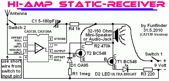

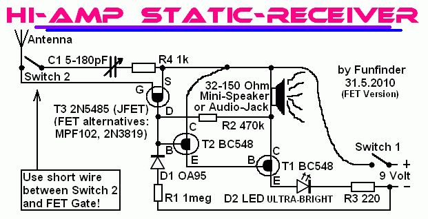

                              Hi-Amp Static Receiver
                              Here are the final and complete schematics:

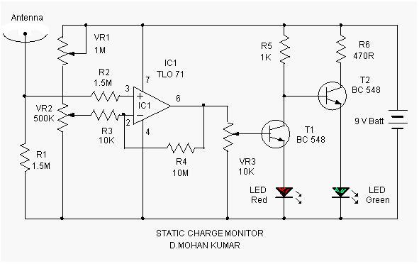

                                Far better tha this stollen "by Funfinder" versions is this D. Mohan Kumar version, which can distinkt between negative an positive ions:
