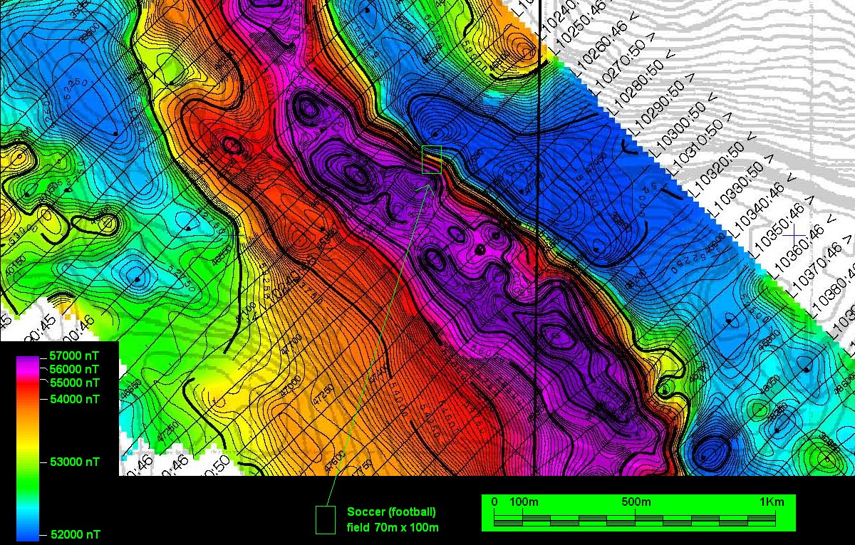

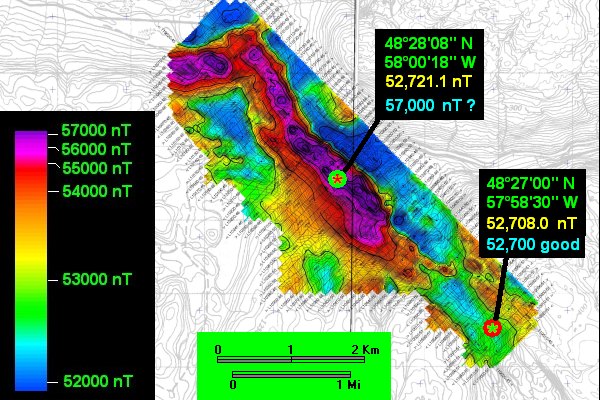

                          For example, the image below shows a magnetometer survey in newfoundland with a magnetic field variation between 52000 nT and 67000 nT within a distance of about 100 meters (328 feet).
                          This amount of variation in magnetic field strength means the NMR frequency of hydrogen changes from 2213.72 Hz to 2742.59 Hz when you walk 328 feet!
                          In other areas of the survey, we see a more uniform field.
                          But we have no way to know if the NOAA reported field strength is the same as even the areas of uniform field unless we measure the field with a magnetometer.
                          Let's see what NOAA has to report about the two corners of that soccer field sized area today:
                          NOAA reports for the lower left corner : 58°00'20" W 48°31'40" N = 53,567.0 nT
                          NOAA reports at the upper right corner: 58°00'15" W 48°31'44" N = 53,567.1 nT
                          They show the two corners to be 0.1 nT difference... not the 5000 nT difference that the geological survey measured.
                          Was NOAA wrong, or was the magnetic survey company wrong?
                          We expect the absolute field value is different today than when the magnetometer survey was made, but the 5000 nT variation across the two corners of this field does not change.
                          We should still find somewhere close to 5000 nT difference, but NOAA is reporting 0.1 nT difference, or essentially the same field strength.
                          We know NOAA did not report the true field strength, and we know the NOAA report does not give us a usable measurement to calculate the NMR frequency.
                          How can the NOAA report be wrong?
                          Because there are so many variations in the earth's magnetic field, NOAA only publishes the interpolated averages for an area that do not show these variations we could measure.
                          Thus the NOAA daily report for this location is only the average for a large area of the map, with no indication of what the actual field strength is at any area the size of a soccer field.
                          In fact we cannot even expect the areas of uniform field strength to be accurately reported for this map, because the NOAA interpolation is for a larger area than we would normally search on this map.
                          The only way to calculate the NMR of an element on the ground is to begin with the actual magnetic field first
                          The point is the only way you can know the NMR frequency where you are standing is to measure the field strength with a calibrated magnetometer like a geologist does.
                          Unless you measured the magnetic field strength with a magnetometer before making your frequency calculation, it is highly unlikely your oscillator was set to the actual NMR frequency.
                          Did NMR find your silver, or was it something else?
                          This raises serious questions about what NMR frequency you were using with your oscillator.
                          In other words... Did you measure the field strength where you are standing with a calibrated magnetometer before you calculated what frequency to set your oscillator?
                          Or did you use the NOAA interpolated field strength in your area to calculate the NMR frequency?
                          If you were finding silver, then I would think we cannot attribute the silver finds to an oscillator resonating at the NMR frequency.
                          If you really did have exceptionally good silver recovery results, I suspect the results must be attributed to a different cause than NMR frequency.
                          My question is:
                          How certain are you that your oscillator was set to the actual NMR frequency of silver when you were finding silver?
                          P.S.
                          Take a look at the image below from this website: http://triplenineresources.com/proje...ation-updates/ and http://triplenineresources.com/wp-co...10/10/MAG2.jpg
                          You cans see the large variation in the earth's field when you walk across the length of a soccer field.
                          But if you check another location in the map, you can find areas that have fairly uniform field strength.
                          The problem with the NOAA daily report is the value they report is about 53560 nT (within 20 or 30 nT) for everywhere on this map.
                          you could not possibly find the correct NMR frequency when using thier reported value.

                              What causes magnetic gradients in the ground?
                              To start, the tiny area of the map I showed has a larger magnetic gradient than other areas of the map.
                              We can expect the NOAA report will not catch this high gradient in their interpolated values.
                              However, this is not an abnormal area that was mapped. Most magnetic surveys I have seen show gradients which are similar even when they are not in a mining area.
                              In most magnetic survey maps that span several miles we find areas where there are large gradients and small gradients.
                              These gradients are not caused by silver or gold veins.
                              They are caused by folds and faults, or other geological movements of the earth which concentrate minerals that are more magnetic or diamatic.
                              In addition to the folds and faults, there are also other geological forces such as erosion, glaciers, and volcanos which move earth materials that can alter magnetic fields.
                              Even sediments and overburdon can contain pockets of materials that concentrate magnetic fields.
                              Gold and silver metal or ore veins do not contribute substantially to these variations in the magnetic field.
                              But magnetic sands, rocks and even foriegn objects located at or under the surface do.
                              The places where you find large anomalies are places where the earth has moved and shifted the position of the materials that can focus a magnetic field.
                              If gold or silver ores or treasure items happen to be in these places, then their presence does not have any direct influence on the magnetic field gradient.
                              Let's see what happens outside the strong gradient area:
                              We know the strong gradient I showed over a 100 meter span could be hard for NOAA to catch in their interpolated reading for the area.
                              But what about the parts of that map that do not have a large gradient?
                              Suppose we check the NOAA report for the large blue area at the bottom, and the center of the large purple area in the center.
                              We can see these two areas are about two miles (3 Km) away from each other.
                              Let's see what the NOAA reports for field strength in these areas that do not have a large gradient (see image below).
                              NOAA reports the lower blue area to have a field of 52708 nT, while the survey measured to be 57000 nT.
                              This means that the NOAA data for today is coincidentally the same as the magnetic survey crew measured back at the time when the survey was done.
                              This is good for a base reference so we can see if we find the same relative field strength in other low-gradient areas of the map.
                              Now, lets take a look at the dark purple area in the center...
                              NOAA reports a field of 52721 nT in the center of the purple where there is no strong gradient. But the survey crew measured 57000 nT.
                              NOAA is off by 4300 nT!
                              This is not a heavy gradient area. It is the center of a large uniform area over a mile long.
                              We see the resolution of the NOAA interpolation does not include this particular location.
                              So we can be walking along the purple area for a mile or so and have no idea that we are using the wrong NMR frequency calculated from the NOAA report.
                              How far off are we?
                              We set our oscillator to 39.4 Hz after we check the NOAA magnetic field value and made a calculation.
                              But if we take the actual measured magnetic field value, we find the actual NMR frequency is 42.5 Hz.
                              There is no way we can pretend these two frequencies are about the same.
                              What further complicates the error is the magnetic field changes during the day. And NOAA does not give us updates throughout the day every time the field changes strength.
                              We see the frequencies calculated from the NOAA reports are highly unlikely to give the correct values unless we are lucky enough to be standing in a patch of ground which has the same value at the moment as was published by NOAA.
                              And our Ipod did not tell us we are in a heavy magnetic field gradient.
                              There are many areas like the purple area I showed on the map. Your own area has many places with a flat gradient that NOAA does not interpolate near the correct value.
                              And the Ipod shows us the magnetic gradient is fairly even, so we are walking along thinking everything is ok.
                              As we leisurly stroll past the four buried treasure chests from the 1852 bank robbery, we are not disturbed by the chests with the 40 pounds of gold about 5 feet below where we are walking.
                              According to the NMR knowledge that makes sense, we could determine a person using MFD does not have his oscillator set to the NMR frequency except on rare occasions when he happened to set it at the correct frequency by chance. The calculations a person might make could bring him somewhere close to the NMR frequency, but not likely at the correct frequency. At this point we can conclude that MFD is not related to NMR because MFD oscillators are not tuned to NMR frequencies, and because a low voltage oscillator does not resonate with distant atoms at a different frequency.
                              Or we could look further into the part of MFD that doesn't make any sense.
                              According to the nonsense part of MFD, an Ipod is good enough to measure the magnetic field strength because precision is not important for NMR. 32 Hz give or take 1Hz works fine.
                              If this is the case, then of course, there is no reason to know the magnetic field strength any more precisely than an Ipod or a cheap magnetometer with a solid state fluxgate chip will indicate.
                              Of course, since it makes no sense, we can't expect people who understand the dynamics of NMR to believe MFD is utilizing these dynamics.
                              But we are taking an excursion into nonsense, with the hope that by the end of the tour we may find some sense in it.
                              Even though MFD does not make any sense as you say, there is always a final way to break through the barrier of disbelief...
                              The proof of the pudding is in the tasting.
                              I propose we try your experiment and see if anyone finds any response for the frequencies you suggest.
                              Let's all of us who are interested try it out and see if it really works to connect a 5v oscillator to L-Rods.
                              Why not tell us exactly how to build the rods (size and construction details), and give us a circuit diagram for an oscillator you consider suitable to connect.
                              Be sure to show how to connect the oscillator and any grounds. Also instructions for how to use the rods, and what they are supposed to do to indicate the target material.
                              If we see some results, then we will have a reason to figure out some real explanation how it is happening.
                              See illustration of how NOAA does not tell you the exact magnetic field strength where you are standing. It only interpolates the general value for a large area.
