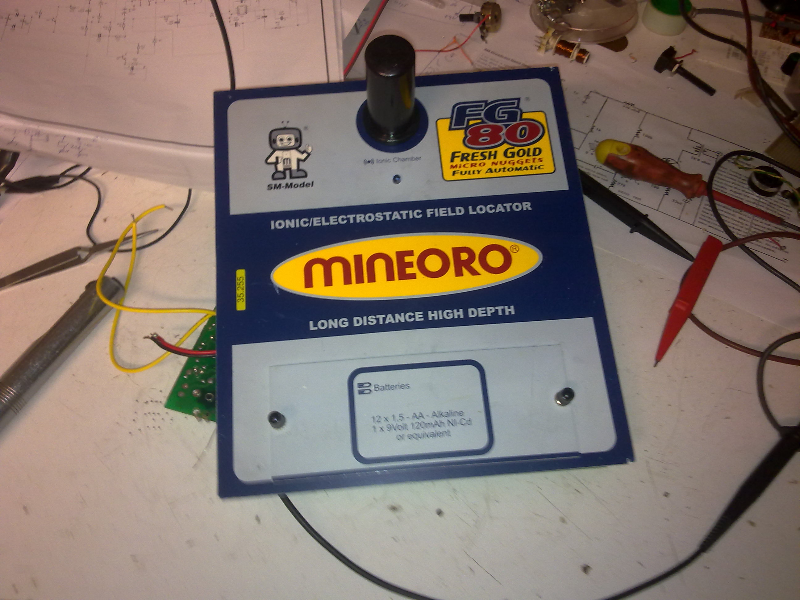

Old 10-24-2012, 09:34 PM
Now i have a FG80 for modification.
What i saw.... it's the same locator with the DC2008. The only difference is the IR led that the FG80 has in the front panel but i don't think if it works.
All the other are the same with 2008.
Also it has different frequency...

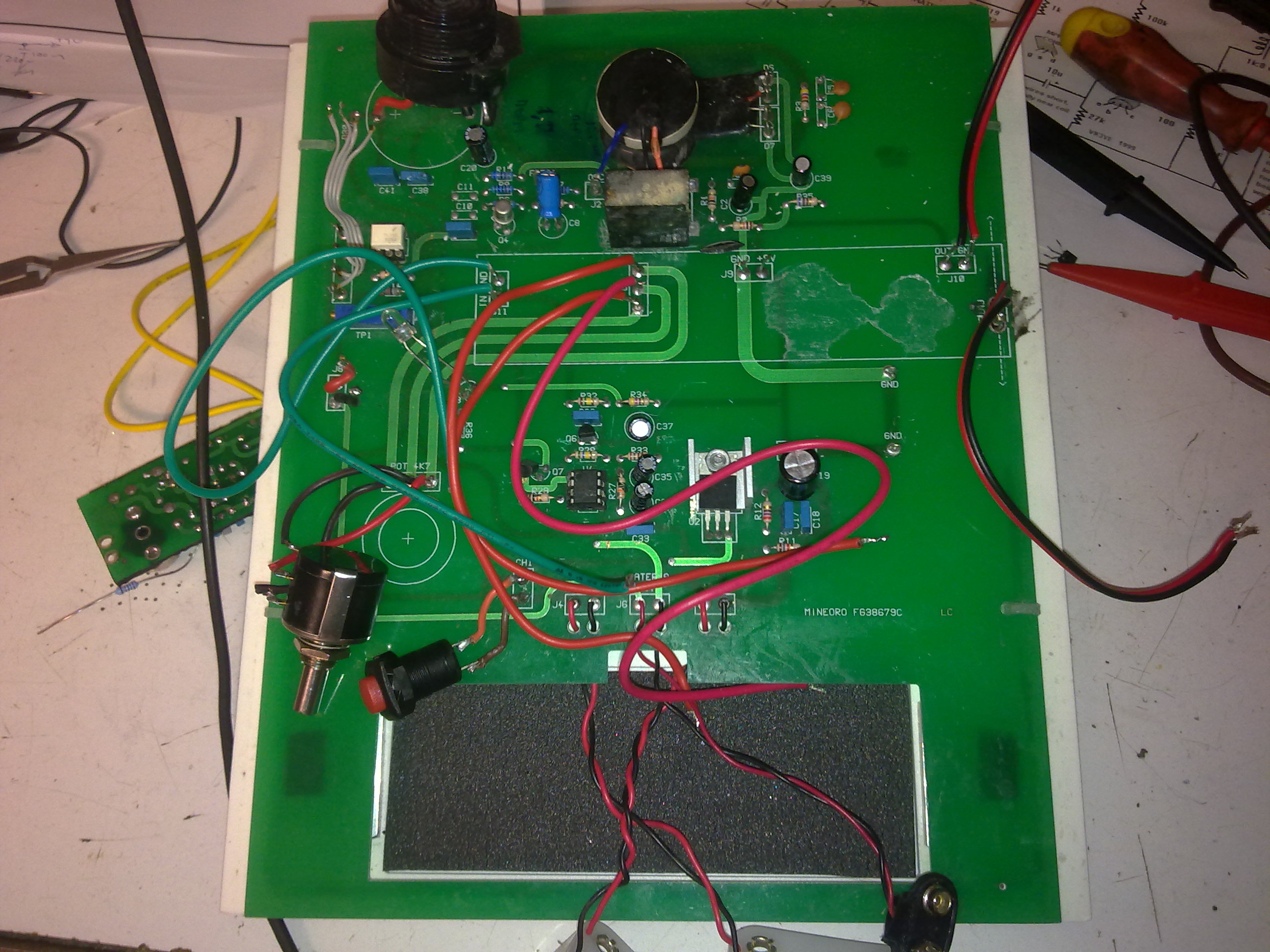

Old 04-11-2013, 03:48 PM
DrTech's Avatar
DrTech DrTech is offline
Join Date: Mar 2012
Posts: 48
Default remove the epoxy resine
Today a friend gave me a DC2008 to modify it. He wants to replace the sensitivity potentiometer with a multiturn one.
I opened it and i saw that the previous owner had open it and had remove the black resin from the receiver pcb.
Also i saw that there is a problem with the oscillator (2N2646).
So i said that it is time for a reverse engineering until i receive the multiturn potentiometer.
I Must tell that my friend found some small objects (ancient coins etc..) with it at small depth (10... 30 cm).
I attach some photos from it...
hello GEO.
how I can remove the epoxy from a circuit.
My circuit is part of a Mineoro DC2008.
You have Mineoro DC2008 scheme?.
DrTech, Mexico.

Hi. somewhere in forum i put the receiver of DC2008. I have not all the value of components because it was a hard work. Had to be desold all the components. Why you need to remove the epoxy????. A good way is to warms and cools it many times.
Thanks GEO,
Why you need to remove the epoxy????. Mineoro "NO POWER ON"
I've fixed some problems that had mineoro DC2008.
1. - Potentiometer not connected correctly.
2. - battery Holders broken.
3. - Ground wire with false contacts.
Mineoro POWER ON
Detects a spark 1.5V to 60cm.
Can anyone tell me if the operation is normal DC2008. that can detect a spark 1.5 to 60cm.
