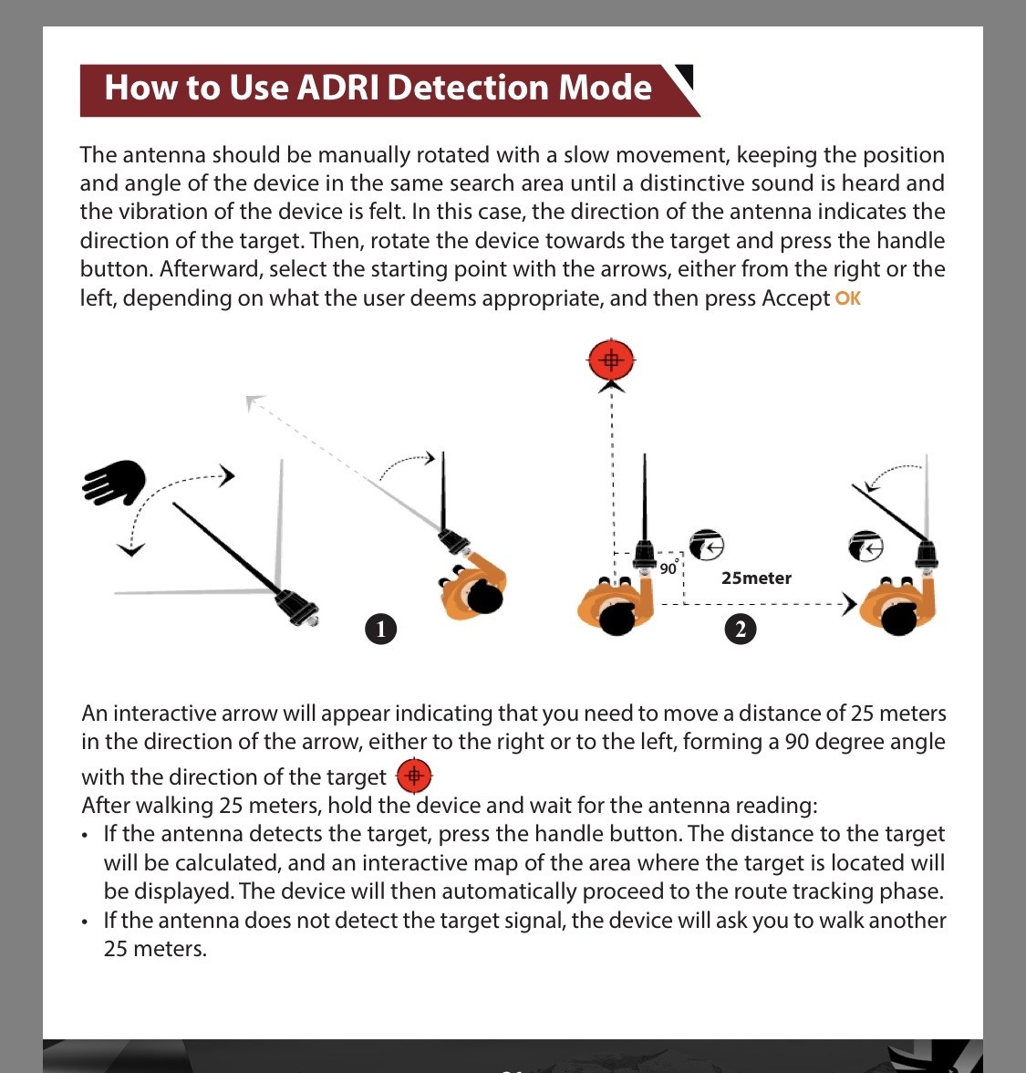

In the manual mode MDRI I do a sweep to start out. I’ve found it works best for me to sweep about 90 degrees in one direction and then sweep back the other direction.
It’s right at the start and end of the sweep where problems can occur more easily. When it finds a target the antenna stays pointed at it and the main unit keeps sweeping. Then I square up the antenna with the main unit and sweep back the other direction. I’ve tried short sweeps back and forth rapidly and it’s just not as good. The long sweep keeps smooth movement and less chance for error.

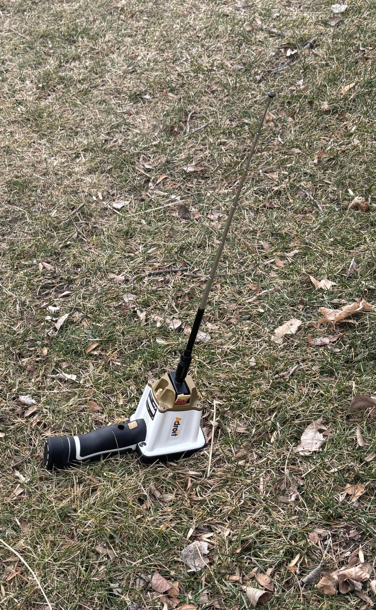

Today I just left the frequency adjust at zero and held the antenna near level. It worked fine. I had light wind today but I’ve tried to work in higher wind and it’s not easy. Tilting the antenna down some can help but it also reduces sensitivity. That might not be an issue for a nice long time buried target.
