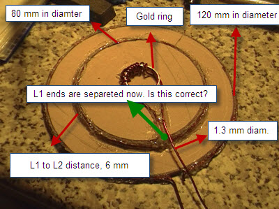

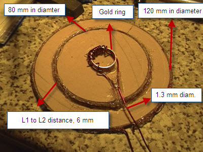

            • Hi Morgan.
              Has you request, here is my sketch from my zahori antenna.
              If you found something wrong, please let me know.
              Regards and many thanks
              please,make one draw with your ANTENNA configuration,like this i can correct the error.
              • Hi nelson
                when L1 is 80mm and L2 is 120mm , so L1 to L2 distance should be 20mm! but i know what is your intention, L2 is 6mm below the L1. true?
                mehdi
                • Hi Mehdi.
                  Yes the distance from L1 to L2 is 6 mm.
                  Also i discover that i join and solder both loop ends of L1 and this join also to solder to the wire that runs to the gold sample and then to G of 2N3819. So now i separate both loop ends and sensitivity seems to work fine.
                  Something strange happends too, when i touch witn my finger the wire that comes fom G of 2N3819, cause sensitivity incres and you can detect my home lamp switch from about 60 to 70 centĆ­meters very easy. So for shure my problem is with antenna.
                  Do you have any other idea about it?
                  Di you build your own zahoria and what are your expirencies?
                  PD: see my sketch id is rigth
                  Originally posted by mehdi View Post
                  Hi nelson
                  mehdi
                  • zahori
                    Hi Mehdi.

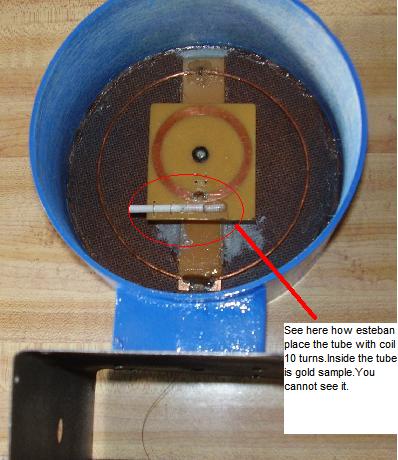

                    Everything looks normal except the wire around the sample is big,but maybe it works,i think yes,becouse the energy around the gold sample will make it to resonate. The same arrangement you can see inside the head of the Esteban“s Blue PD,in this case the gold sample stay inside the tube.
                    • Hi Morgan.
                      Well, today i changed the wire. Now i use 0,51 mm wire for L1 and L2, and also for the gold ring.
                      I also gave more distance btw L1 and L2. Now is 2 centimeters.
                      On my test i notice a little more distance to detect my AC wires running thru the walls of my house. But if i touch with my fingers the wire that comes from G of 2N3819, sensitivity increases a lot, that the wires on the wall can be detected at a distance of 1 meter and this doesn“t lose directivity from the antenna. Also i detected some kind of static coming from plants outside of my garden and i don“t know if this is normal.
                      When i made the test with my old tv set, detection distance is not to much, about 1 meter. This TV uses flayback and the screen is 14" wide.
                      To know if this is working on gold, what test could i make, cause i suppose that this divise is much more sensitive on gold samples than on AC current?
                      Here is a poor quality video that shows how my zahori is detecting ac currents from my lamp switch
                      Regards and thanks in advance.
                      [ATTACH]14725[/ATTACH]
